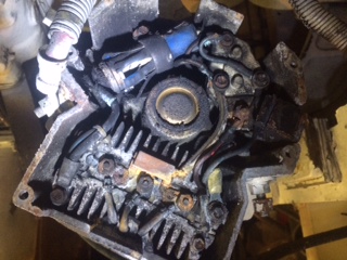

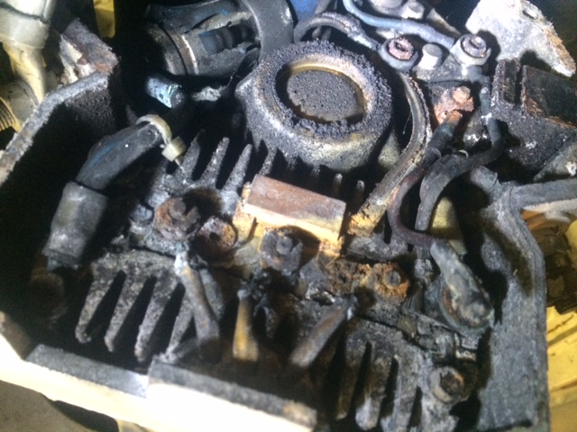

    Hi Guys,
    Sorry for the long delay. Got caught up in Summer family vacations and work.
    Anyways I opened up the Alternator and it was completely full of salt. This was damaged when I sprung a saltwater leak from my Starboard engine after cooler and it pretty much ruined it along with my tools, Starboard engine aftercooler clog, etc. I learned my lesson with clamps. If you are replacing all of them when you do your after coolers, don't be lazy and leave out two because you didn't buy enough.
    Here are some pics of the Alternator.
    Thanks Again!
  3. Capt Ralph
    14,578
    Yep, Failed smoke test. No telling what was damaged by water.
    Start shopping ebay & the web. Get an idea what a used or rebuilt cost, Then take it to a repair shop. You will have an idea what repair vs replace cost could be.

  4. Capt J
    14,898
    Take it to Greenlight auto electric in Plantation,FL. They're good guys and do good work and will rebuild that alternator no problem....
  5. Chasm
    Chasm Senior Member
    Mar 30, 2013
    137
    Needs Lucas P/N 530433 :D
    The combination of salt water and electricity is Not Good(tm).
    Looks well fried on the electronics side. If you go for a rebuild don't forget the bearings.
  6. CaptOz
    CaptOz Member
    Apr 13, 2009
    100
    Miami, Fl
    Bought New Alternator
    I picked up at replacement alternator from a shop in Miami. Its was $215 plus my core. Installed it and all is good!
