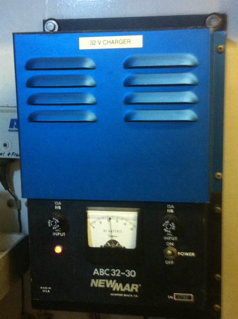

    Some advice please.
    My Hatteras has the US electrical system, 110v mains 60 Hertz.
    While I was in the US finalising the purchase of the boat, I had an Acme Transformer installed which allows me to plug in the 230 volt power in Australia and it operates the 110v appliances on the boat.
    Australia has 230volt 50 Hertz. Whenever I moored at a marina the fridges and appliances worked fine but not all the Aircon units, which I assume is due to the single phase feed.
    I have been on a swing mooring for 18 months and only occasionally have used shore power.
    Finally I have been able to install a large mooring pontoon at my home and will have permanent shore power.
    Here is the problem I discovered:
    I found that when I use the shore power to charge the batteries, the charger runs up to about 25 amps for a short time and then automatically shuts down. The batteries are not getting charged.
    When using the generator, the batteries are getting a full charge.
    Also, this could be co-incidence, but the galley fridge compressor has seized and I am about to replace it with a new one from the US, it was very old (1978). The freezer works fine.
    1. Is it a problem with the charger or is it the Hertz and if so, is there a remedy?
    2. Does the difference in Hertz shorten the lifespan of appliances even when only used occasionally with shore power?
    On my previous boat, I had a similar set up with no problems.
    Thanks for your time.

    Australian 50Hz causes all US appliances/motors/air-conditioning to run 16% slower.
    This can cause all sorts of idiosyncrasies including engines to run hot and trip-out from thermal overload. The reason is that they are not designed to run at the slower speed (pulling the same load) and the fan/cooling design won't expel heat fast enough.
    You can fix the problem by getting your transformer replaced with one that does both 110/240V and changes frequency to 50/60 Hz.
    Will cost money though ... sorry.

    You have been hit by a problem that used to cause lots of problems till the advent of the solid state shore power units.
    As mentioned previously the 50 Hz power will cause your motors to run slower and overheat. It will also cause problems with anything that uses frequency for timing - Microwaves etc.
    You will find that many fridge compressors are rated to run 50/60 hz which is why you might have got lucky last time and still have a working freezer.
    The long and the short of it is you either need to install some type of converter , get things that can do both frequencies or change the boat to 230 V 50 Hz.

    Like K1W1 said, you need a frequency converter. There is no transformer in the world that will change frequency.
    I suspect that you will discover it is far more economical and practical to either change your consumers to 50Hz or 50/60Hz units.

    Here is the model number of the transformer on board:
    Acme Electric
    TF-2-79267-S
    I checked on the website and it states it is an:
    Export Model
    190/208/220/240 x 380/416/440/480 Primary Volts - 120/240 Secondary Volts - 1Ø, 50/60Hz
    I am told a frequency converter is approximately $20,000.
    Here is what I think I may end up doing, at least until business is better and I can change all the compressors:
    Use the present transformer when on shore power for lighting and fridges, I have just bought a new compressor in the US for the fridge and it is 50/60 hertz, the rest will get replaced as they die out.
    Use the existing battery charger via the generator and find a 230volt 32v charger which I will power directly from the shore outlet when needed. In other words leave the existing charger running off the generator and add one using the local voltage when on shorepower.
    When we need microwaves, ovens etc. then the generator will be used.
    We don’t use the boat at the marina or on our pontoon much, but use it a lot for cruising/fishing so the generator is the main source.
    Your thoughts?

    I think you have a good economical solution to your current problems there.
    Is that Charger 220 or 110V?
    Given it's vintage I wouldn't think that it has too much in it that will be cooked by 50 Hz supply.

    I believe it is 110V, probably 10+ years old.
    There is plenty else needing upkeep on the boat now so its priorities!
    Cheers
  16. K1W1
    7,442
    If it has run on the Shore Power you have fed it so far and not fallen over I would say just keep on feeding it the same as it doesn't look like a charger is a cheap option either at this stage.

    Agree with that. The batteries seem to charge up quick enough off the generator (although they are new).
    Meantime lets see how long and how much a 230volt 32v charger is?
