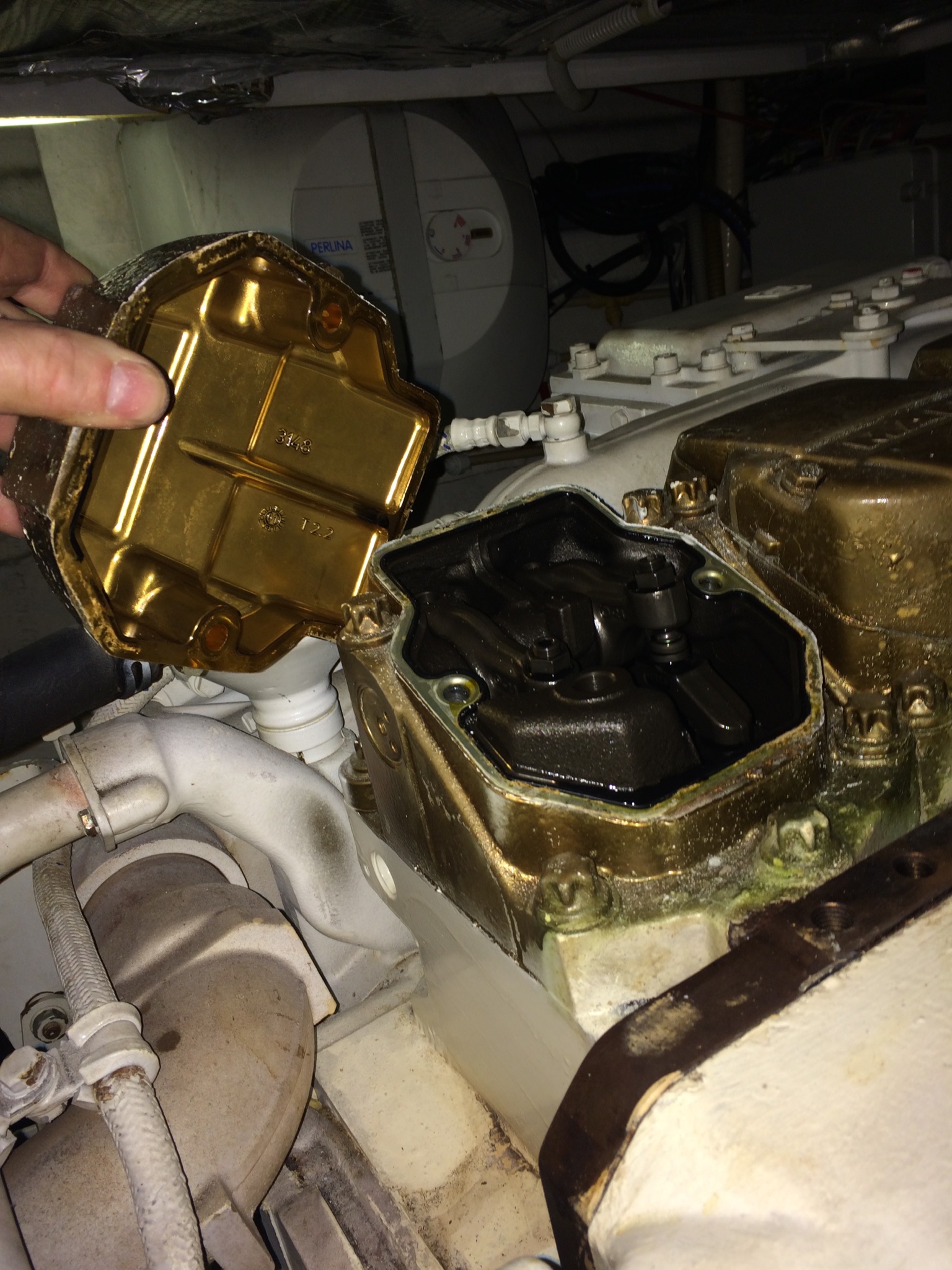

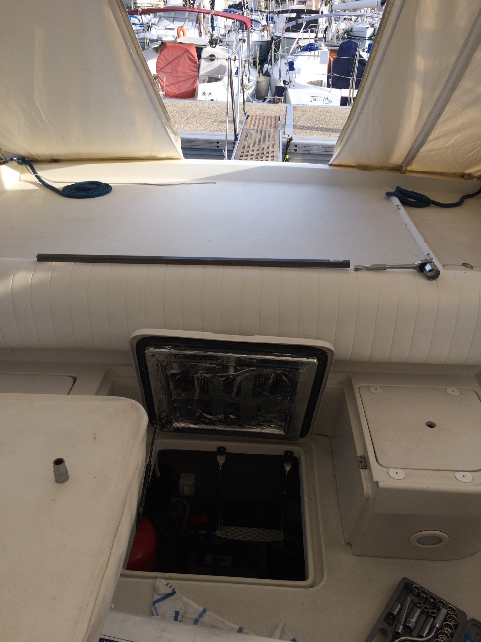

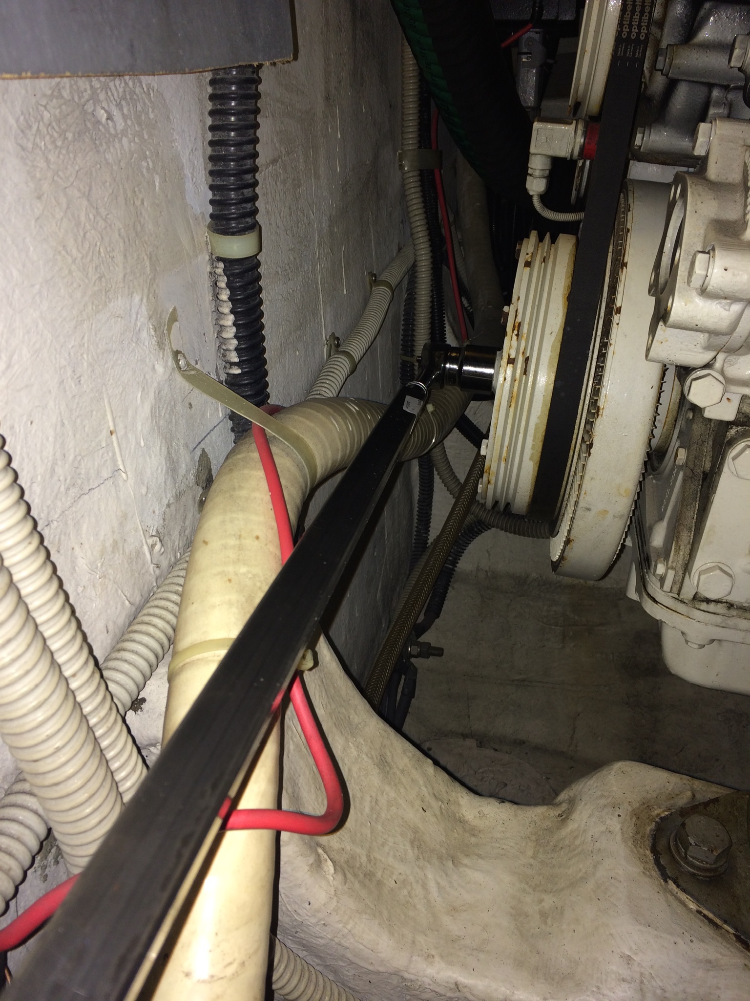

    1- You need to hand turn it first .
    2- As MapishM said it’s a 32 mm socket .Use a 1 m long or as long as you can fit bar .I use a square box section bar which slips over the tool socket 10 inch handle .

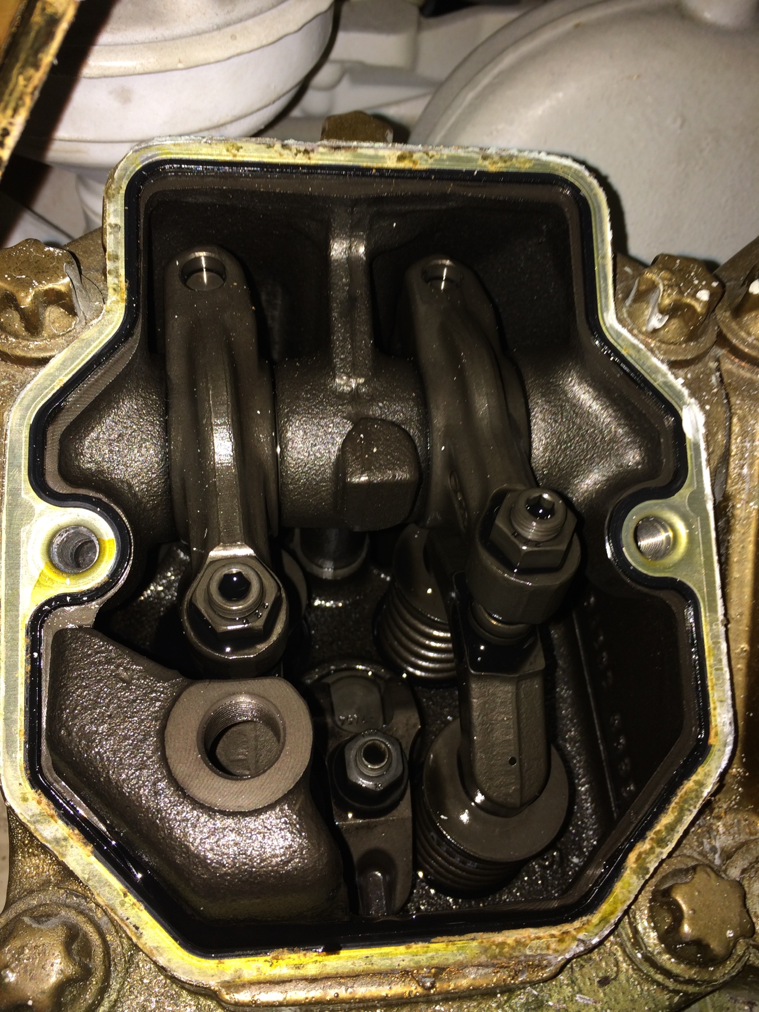

    3- remove the valve covers ( 14 mm socket )
    4- use the front main crank pulley ( actually it’s damper ) to turn it .
    Maybe a two man job ….one turns other watches carefully the rockers move and valves descend /ascend .Get the firing order from the manual or internet .
    Obviously school the turning guy about feeling an obstruction.
    If it’s pretty much ceased or feels stubborn, then consider removing the injectors .Two reasons .
    1- pour a 50/50 solution of diesel and auto transmission oil in the pots .Better still try and spray it in .Leave 24 / 48 / 72 hrs intervals and try turning again and re lubrication.It will free up ……with time if the rings have rusted to the cylinder walls .
    That’s the main issue , your gotcha if you connect a new battery bank and just attempt to fire it up the stuck rings will fracture and then you are into a rebuild / cylinder strip down .
    1- while the injectors are out have them sent away tested and tips if necessary replaced .
    Obviously it needs fresh fluids , filters and water pump impeller.Assuming it fires and runs .
    The socket and it’s bar extension. ( on the seat back )
    On the main crank pulley , note enough bulkhead clearance and only a 1/4 o clock space to move it but it’s a ratchet anyhow .
    Valve cover off .You can reuse the gasket btw .Not ideal but do able .
    Get the firing order or the valve adjustment rocker method sequence and carefully watch them fall/ rise and your mate ratchets the crank pulley.
    This area will be bone dry in a eat your dinner off it hygiene if it’s not been run for years .The oil runs down .
    If it’s not been run for a while and you do free it up and it appears all that should move is moving in the right way , you can still get a sticky valve. One due to corrosion of the valve seal or valve bevel does not quite get a proper gas tight seal the engine will tick .Tick , tick tick or if the gap is large bang bang bang .A gentle warm up ( do your gen service first ) and run and they re seal as the crap burns off , but gently gently .Don’t go out of the marina and pin the levers .
