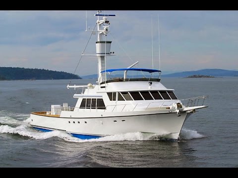

    Or he could look up the “ original” mini-mothership, the 88’ Jones Goodell MY by Jim Jenks of OP clothing fame had a crane to load a 30’ SF behind the deckhouse.
