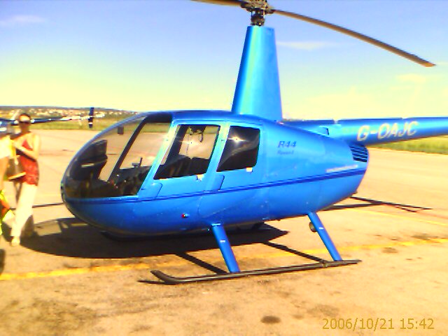

  5. Crewagency
    Crewagency Guest
    Some flight impressions from Mallorca
    Thats what we want to put on the yacht. That was my first Heli flight and I will never forget.
