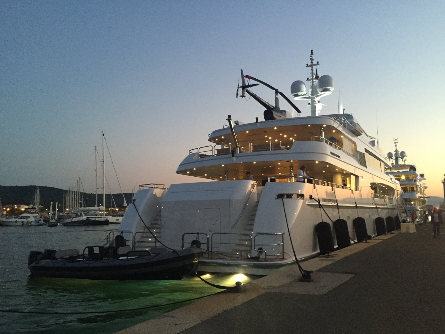

    This is supposedly a picture of the same boat with a smaller helicopter onboard, looks like a Robinson.

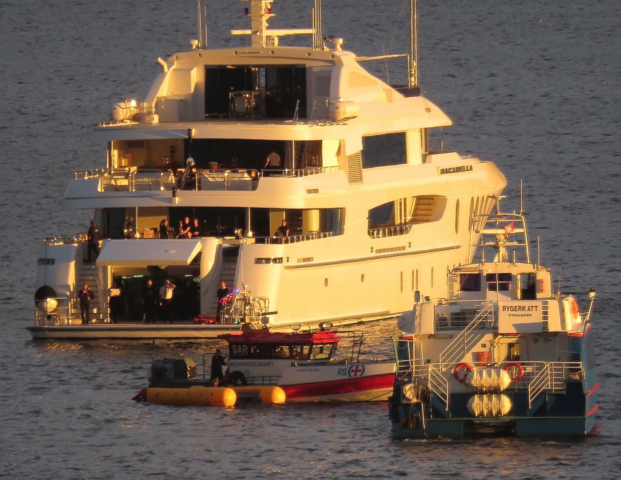

    IMG_0839.JPG This picture is taken 5 minutes after the crash:
    The chopper is floating upside down, the yellow pontoons keeping it afloat, they were activated manually by a quick thinking pilot just before the crash.
    Looks like 9 crew members on the boat are watching the recovery operation.

    I've reviewed the available videos, in depth, with my crew. We believe that the loose article was actually a canvas cover for a fueling station (lift pump/hose reel). If you look at the photo in Post#29 you'll notice a large cube-ish rack on the top deck of Bacarella, which doesn't look as if it belongs on the center of the sundeck. I suspect that is the fueling station, that was likely retro-fitted for helo-ops.
    With such an unsightly piece of equipment in the midst of a guest area, it was probably fitted with a canvas cover (as we do on yachts) to dress it up.
    My guess is that the cover wasn't properly secured to withstand the wash associated with a landing helicopter, and took flight when it was subjected to the down-draft.
