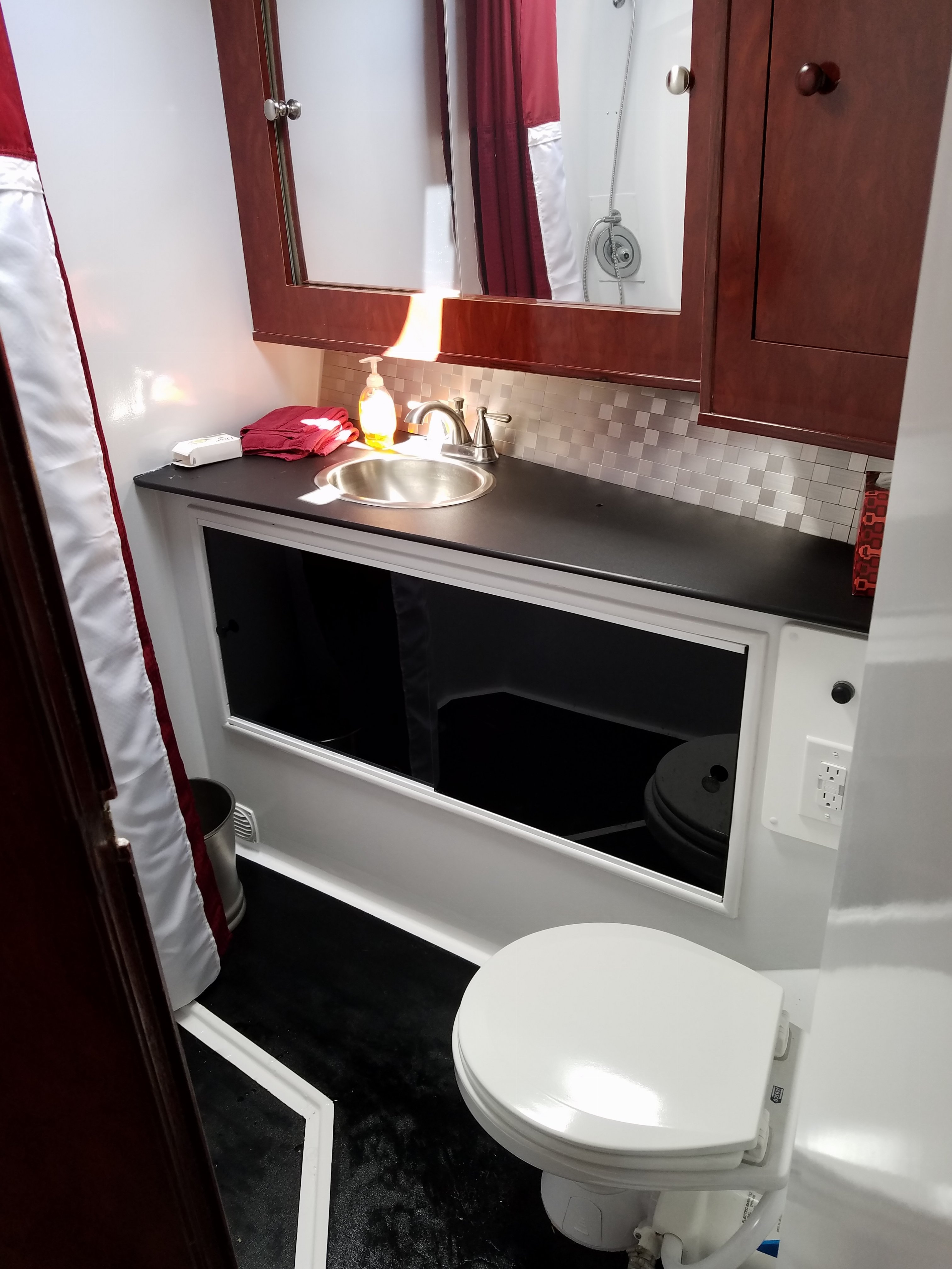

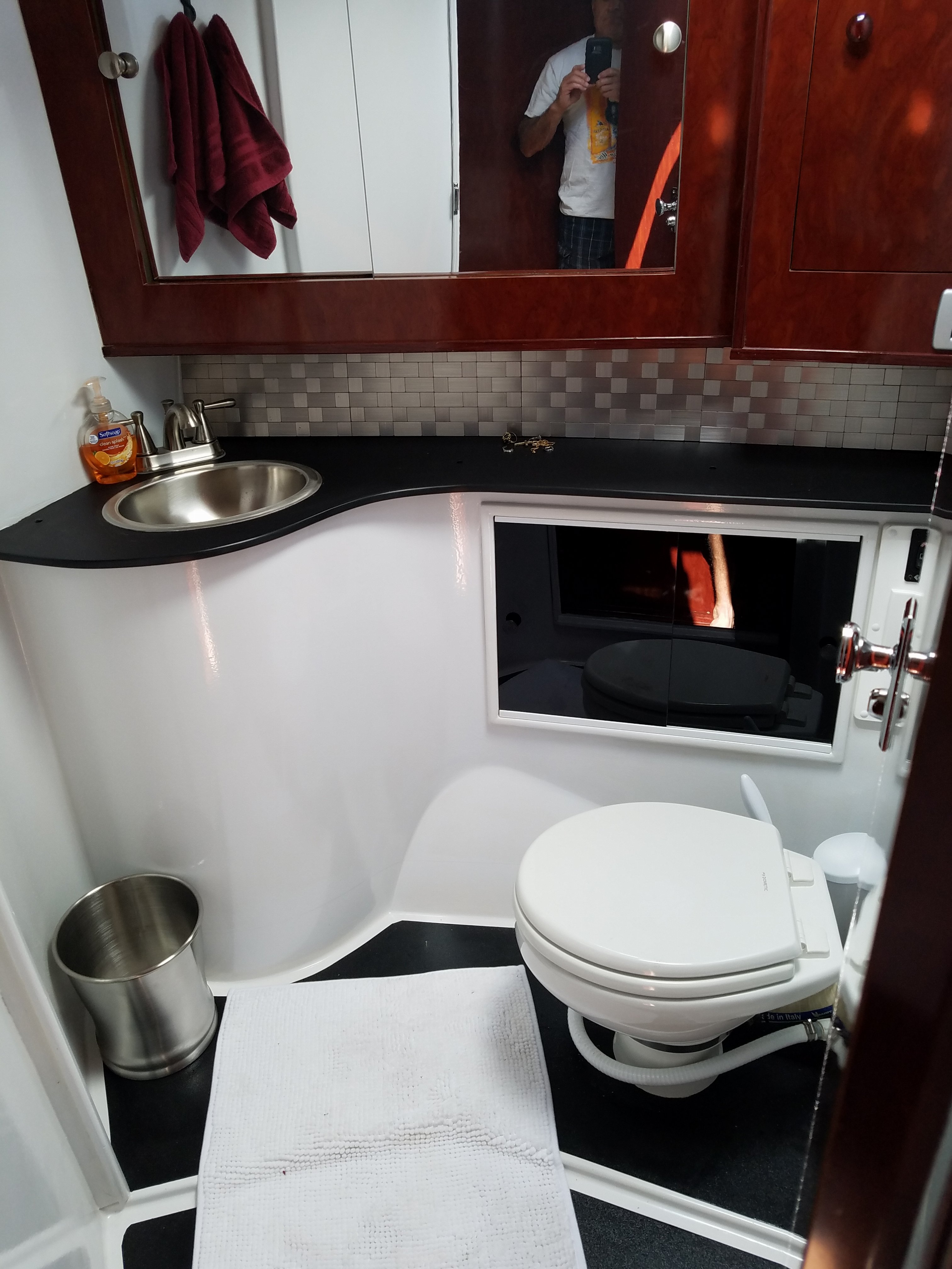

    No I did not. I ended up buying starboard and did it myself. Did you know alro plastics carries a bunch of different colors of starboard? 9 different colors to choose from. I thought they only made white, seafoam, and black

    White petit easypoxy and black easypoxy..found it at lowes for $18/can..1 can white per head and the black i still have leftover from both heads...black starboard counters...stainless drop in sink and brushed nickel faucet...I removed the lower cabinet doors and put tracks in and had lexan cut to fit for sliders....removed the old glass mirrors and replaced with lexan mirrors also...replaced ceiling lights with led...backsplash is peal and stick tile...real easy to work with....came out to about $1000 per head minus toilets which I reused
