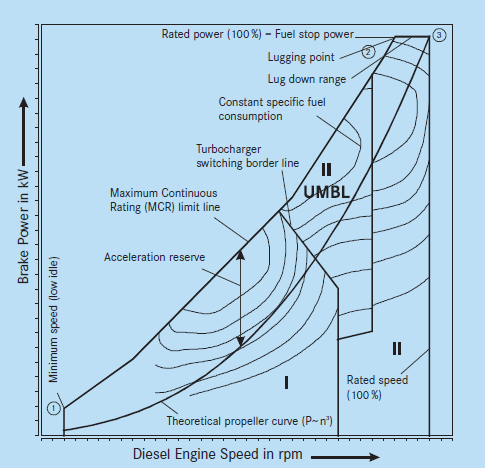

    You have not grasped the concept that the engine does not reach the lug down point until the prop demand exceeds the engines ability to provide the necessary horsepower. We are talking 8 knots, not 12, 14, 16, etc. This diagram should give you a better picture:
    In short, you have ignored the reserve power available in all of your "analysis" as shown in this example of a theoretical power curve.

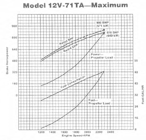

    You just don't get it the lugging concept and probably never will. The graph without figures should school you on the concept first, the numbers would come from whatever engine you select. Just take out one of your boats and run it on two engines at hull speed then on one to get a better feel what you are talking about. Let me know which boat you choose and I will give you the hull speed.
    The factory fuel consumption data for the propeller load on a 12V-71TA shows the following:
    1200 rpm - 9gph
    1400 - 12.5 gph
    1600 rpm - 17.5 gph
    1800 rpm - 23.5 gph
    2000 rpm - 32 gph
    2200 rpm - 42 gph
    2300 rpm - 48 gph
    This is the factory data used to analyze propeller / engine matching. In a single screw application you are falsely assuming that the rpm is held constant, it is free to move to the point where it can deliver horsepower to make 8 knots. This is not the same rpm that is applied in the twin screw application.

    If you looked at the yachtworld link, you will see that the 80' Hatt has 12V-71TA's, 870bhp, and without knowing the specific boat that is a safe base assumption.
    The factory numbers would show 18gph @ 1200 rpm for both engines and would most likely get to at least 11 knots. So the question has been can you get to 8 knots on a single screw at 8 - 9 gph and this seems absolutely feasible. Main deterrents are locking or cooling the off-line gear and difficulties steering, especially in close quarters. None of your rant provides information that this is not possible. I can ask Covington for their performance graph as well and when I get it we can compare notes. Your sample set of one 80 footer may just show that it was not really dialed in or was an overweight slug, which can be typical.
