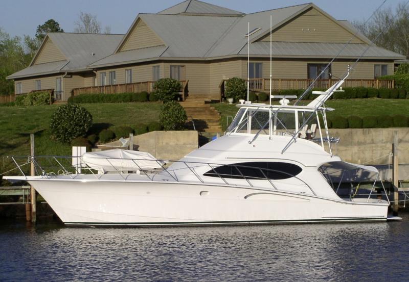

  17. YachtFish
    YachtFish New Member
    Sep 14, 2011
    18
    Mediterranean Sea
    Liberty,
    This is a photo of a 54C I delivered to Italy several years ago, featuring 3 hatches, side port lights and a bow tender with davit (Nautica RIB).
    It should give you a clear idea of the look of your future 54C!
    (The photo was taken in New Bern at the Hatteras yard just before delivery)
