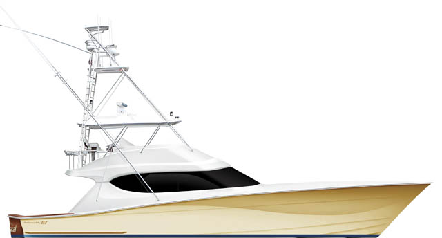

  1. Hatteras Announces New 60 Convertible
    Brand New Design Features Resin-Infused Hull!
    NEW BERN, N.C., May 4, 2006 – Hatteras Yachts is pleased to announce an exciting new product that solidifies this legendary boat builder’s position as the industry leader in high-tech sportfish design. Featuring a mezzanine cockpit, lightweight construction, tumblehome curvature in the hullsides and an exciting new tournament edition, the Hatteras 60 Convertible is unlike any production boat in the marketplace today.
    From the beginning of this model’s design process, the Hatteras product development team has focused squarely on performance and fishability as top priorities. As such, the new 60 Convertible represents a paradigm shift for the company. Built in Hatteras’ new facility in Swansboro, North Carolina, the 60 will be the first Hatteras to feature a completely resin-infused hull, rather than one built up of layers of hand-laid fiberglass. The resin-infusion process produces a more uniform hull thickness from one hull to the next, as well as the most ideal glass-to-resin ratio possible. This one-two punch produces a boat that weighs significantly less because of the lowered resin content, while providing a more precise fit of bulkheads, stringers and other components for increased strength and durability.
    The solid-fiberglass hull bottom includes beefy support for key areas such as the tunnels, shaft log and strut locations. Divinycell coring is infused into the hullsides, decks and superstructure to add stiffness and reduce weight. Wherever possible in the vessel’s interior, lightweight components and materials are used to increase performance without sacrificing the structural integrity and soft ride that have been the hallmarks of Hatteras Yachts for more than 45 years.
    Thanks to the boat’s lightweight and efficient hull design, the 60 Convertible features a performance-enhancing drive train turning eight-blade Nibral propellers. With this package, the boat’s 1,800 gallons of fuel will provide a range of 500 nautical miles at 1,950 rpm. With standard Caterpillar C30s at 1,550 hp each, the 60 is projected to cruise at 30+ knots and hit a top speed of 35+ knots.
    For the hard-core fishermen, the Hatteras 60 will also be available in a 60GT TOURNAMENT EDITION. This three-stateroom, two-head package includes an engine upgrade to 1,800 hp, custom hull color and a wraparound windshield styling element. Owners of the GT TOURNAMENT EDITION will achieve a top end of 40+ knots and a cruise of 35+ knots. Combine this performance package with custom bow rails and optional Carolina Edition teak package, and you’ll have a boat that will sit proud at any tournament.

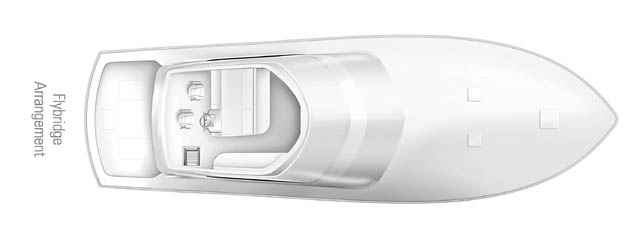

    On the bridge, a large console features a pod-style helm with an actuated console to keep electronics safe from the elements when not in use. Just forward of the console is an insulated drink cooler as well as an optional freezer. Ample rod storage is available beneath the forward and starboard lounge seats. Teak helm chairs are standard, as is an electronics suite including Northstar 6000i GPS/plotter, Icom VHF, Simrad AP26 autopilot, and Simrad IS15 depth and speed indicator.
    An enclosed bridge along with an optional interior stairwell will be available on later hulls. The enclosed bridge will be equipped with a centered helm chair and two riding seats to port and starboard for guests. Aft, a raised sectional will provide visibility and rod storage.

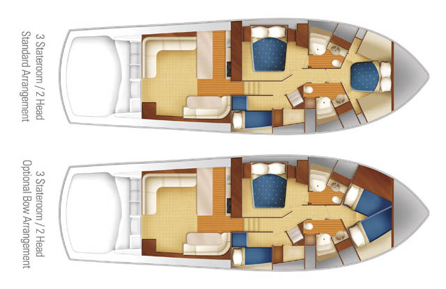

  3. Accommodations...
    The new 60 Convertible features a luxurious salon with a comfortable L-shaped sofa with rod storage beneath, as well as an entertainment center with 42-inch plasma TV. Genuine cherry wood veneers in either a high-gloss or satin finish provide a warm environment, complemented perfectly by any of the 15 standard décor schemes available from Hatteras’ in-house design team. To provide convenience for the crew, the electrical distribution panel is located just inside the sliding door, easily accessed from the cockpit.
    The galley features two under-counter Subzero refrigerator/freezer units, with a third unit available as an option. A four-burner ceramic cooktop and microwave/convection oven provide plenty of food preparation options, while deep storage drawers in the galley’s fascia offer an abundance of space. Amtico strip flooring and solid-surface countertops and backsplashes give the galley an elegant look with long-lasting durability. To starboard, a large dinette features an L-shaped lounge with storage underneath. The dining table features a solid-surface top with decorative pedestal.
    Belowdecks, the 60 is configured with three staterooms and two private heads, providing for ample storage for the rugged sportfishing enthusiast. Overnight tournament fishermen will appreciate the optional bow stateroom that utilizes crisscrossing bunks to maximize sleeping capacity in this 3/2 arrangement. Those who value added interior amenities can opt for a more traditional three-stateroom three-head arrangement. A four-stateroom layout is also available.
    You’ll find an oversized queen berth and a 20-inch LCD TV in the athwartship master suite. Nightstands on either side provide storage, as does a full dresser forward of the stateroom. Twin cedar-lined hanging lockers are accessible aft of the stateroom and provide additional sound insulation from the engine room. The master head features a fiberglass stall shower, Amtico strip flooring and solid-surface countertops and backsplashes.
    The bow stateroom, similar to other Hatteras models, features a walk-around queen berth with cedar-lined storage beneath and an optional 20-inch LCD TV for entertaining. Storage is abundant with twin cedar-lined hanging lockers, drawers and optional cabinets in the hullsides.
    To starboard lies a set of over/under berths with storage beneath. The standard arrangement provides for maximized storage below the upper berth as well as twin lockers outboard, which can be used as a rod locker or bulk storage for long trips.

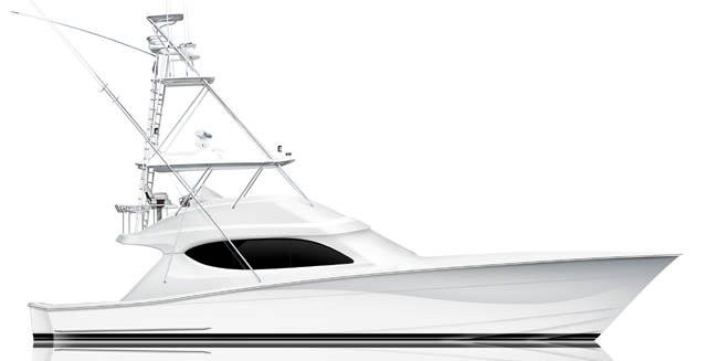

  5. The new 60 Hatteras looks like a honey. Over the years, the 60s have been very kind to Hatteras' bottom line.
    Per the commentary, looks like Hat has continued, as from the very beginning, to paint their boats which IMHO is a good idea. Beats all the gelcoat repairs at the end of the mfg. cycle.
    I find it interesting to read about her bottom. Sounds like the 'warped-panel' design that Harry Scholl called the Delta Conic which debuted in the early eighties and found on the (then) modern Trojan boats.
    Or, maybe a fresh idea?
    Boy, what a profile. This is not your father's Jack Hargrave-designed Hat!
