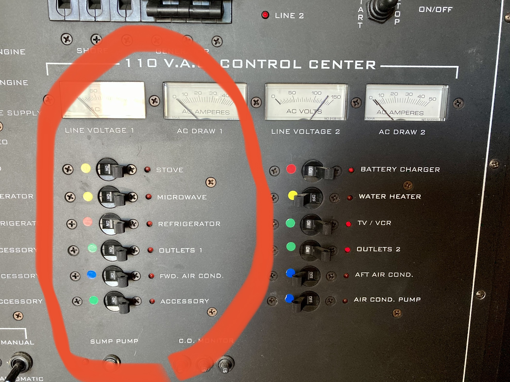

    Hi everyone, just put my ‘04 38 Luhrs Convertable in and when on shore power the left half of my AC panel has no power. If I run the genny, it has power. Thoughts? TY!
  2. Capt J
    14,435
    One leg on your shorepower cord isn't getting voltage on one of the legs would be my thought. 2 of the legs are 120V, third is a neutral. 2 hot legs of 120v, make 240v.

  3. Capt Ralph
    12,748
    If using a 120/240 Vac shore power service, one of the legs is open from a open breaker, or open in the wire lead.
    You may have hidden service entrance breakers also; Usually hiding in or around the hull near your service entrances connects are mounted.
    I recall on some boats this size, there is a parallel breaker on the panel to join both sides to single 120Vac lead.
  4. Capt J
    14,435
    On that boat, Luhrs uses a 240v-50 amp cord, and simply splits the leg to 120v on one side of the panel (left), and 120v on the other side (right) of the panel, they don't use both legs together or 240v systems at all on that size boat.

  6. Capt J
    14,435
    Just the three pole connected together breaker as seen at the very top of the photo.
  7. Rscriv

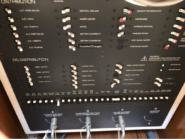

    If a boat has a 50 amp power cord but 110v appliances, can I plug that 50 amp cord into a single 30 amp shore power with an adaptor?

    I have only one 30 amp shore power available at the dock and would like to buy a boat with 50 amp power cord.
    Looking at Tiara 4400 Sovran 2005- I think it has all 120 v appliances

    Man, That's a lot of stuff on that panel.
    I can not imagine a later model boat with the old 120v-50A service.
    I can not imagine that much A/C equipment running on a single 120V-50A line.
    I'm sure it would have 120/240v-50A service.
    Somewhere out of the picture must be A-B Buss switches and volt meters.
    So, make a pigtail joining the red and black wires together, supplied by a single 30A service.
    Still, In an emergency, maybe.
    Myself, Less one hell of an emergency, I would not even try.
