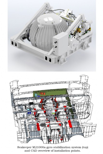

    The prinicipal behind gyros and their use for stabilisation and spacial orientation is quite old and well proven.
    The times for mechanical gyros in inertia platforms and artificial horizons in planes, land vehicles and ships / subs are over, as laser ring gyros without any moving parts assisted and backed up with GPS have taken over this part of technology. Their much smaller size, much lower power consumption and higher accuracy (no precession) have outdated their mechanical brothers for this purposes.
    But for stabilisation of bodies without aero- / hydrodynamic airfoils (fins), the mechanical gyro is still a valid (if not the only) solution. And for fast planning hulls, IMHO, the best solution.
    Gyros for spacial orientation have several gimbals for their freedom around all three axes. If the physical force of a gyro is wanted for stabilisation he can only have one degree of freedom (means one gimbal) because the second "gimbal" has to be the ships hull. Thats why a gyro can only stabilize one axis, for example the longitudinal axis, which means roll.
    The stabilizing force of a gyro is depending on its mass, rotational speed and position and type of mounting in the hull. The best results will be obtained, if the gyro is integrated already in the original design of the vessel.
    The big difference between the Seakeeper and the ARG gyros is, that the gyro in the Seakeeper system is spinning in a near vacuum. IMHO, this has a lot of advantages. The power consumption is lower, because the high RPM wheel does not have any air friction. Less noise is transmitted through the vacuum and the delicate interior of the sealed assembly does not pick up dust and humidity.
    The disadvantage of gyros in general are their high demand of AC power with stabilized sinus wave (big enough sized generator not to be run above cos phi 0,8) and their high spule up and down time. To get that heavy wheel up to that high RPM with the lowest flow of amps, you have to accept longer spoole up times. Because keeping up the vacuum in ambient air is very difficult, you have to pump out the air in certain intervalls. And these units are water cooled. Spoole down time is one more of their disadvantages. If a gyro looses RPM, it starts tumbling with a lot of stress on its bearings and gimbals. To prevent this, you can lock the gimbal and actively put on a break (like a eddy current brake) but when locking the gyro, you should not move the boat. The compromize is, allowing a free spoole down and dampening any tumbling by means of a little hydraulic system.
    During our aquisition phase for my sons IPS boat, we have visited and driven boats both with the Mitsubishi ARG system and the Seakeeper system. We found the the Seakeeper the much better choice as far as noise, power consumption and performance are concerned.
    The Seakeeper system was integrated in the early design of that CRP custom build and positioned in the beginning of the aft third of the hull on the forward bulkead of the engine room and on the longitudinal stringers of the hull.
    After the first season, my son is very happy with the performance and the maintenance issues of the gyro (and the quad IPS :)). The deep V hull with its 10 degree deadrise, specially designed for the IPS system without sprayrails, reacts nicely on the stabilizing force of the gyro, both on the hook and during various speeds. It is a compromize, a system with retractable fins and gyro would have been perfect but there was no space available for both systems. But multiple gyro systems for a bigger yacht are really expensive and space consuming.

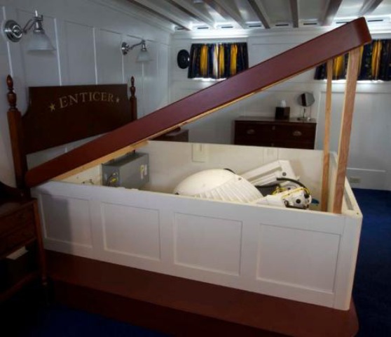

    Below some examples and IMO the worst place for installation of a gyro in a boat. This monster under your bed must be a nightmare :eek:
