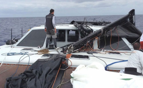

    No, Phaedo was racing
    At the time of the dismasting we were sailing under A4 at around 16kts.
    A satellite phone interview with the team indicated that they thought the top of the mast failed first.
    “We were running downwind with our large spinnaker up, and I was driving the boat and, yeah, heard it — heard an awful crack, and you know, the whole thing came down,” Phaedo owner Lloyd Thornburg said.
    The nearly 80-foot carbon fiber mast landed on the starboard deck and pilothouse roof.
    Without enough spar left to set a jury rig, Phaedo headed back to Los Angeles under power, making about 6 knots with about 250 miles of range in fuel. Because the boat was 500 miles into the race, fuel assistance was needed to complete the trip to shore.
