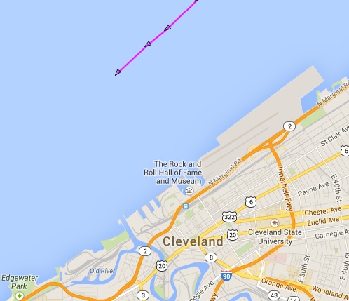

    Will you be visiting the Rock and Roll Hall of Fame and Museum tonight?
    Oops, guess not.
    You seem to have driven past it.
