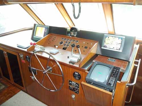

    It's pretty easy to ID the Hynautic ones, anything else on her is likely cable. If they look like the ones in this pic they're Hynautic's and likely have an air problem. They use anti-freeze for fluid and are not that difficult to troubleshoot and/or bleed.

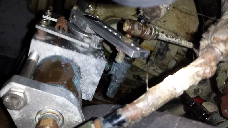

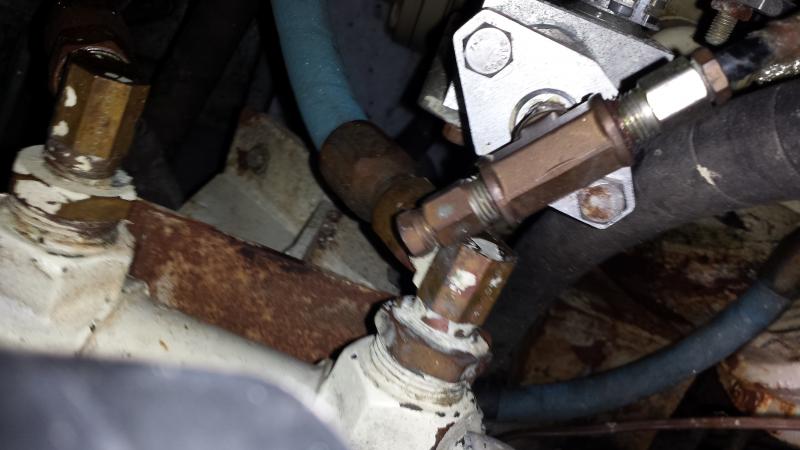

    Pressure & levels are good. Always maintained since the guy who did original refit tried moving boat last winter without checking.:eek: Fortunately he also had fiberglass guys. I saw 2 bleeders (pics attached). Matter which? Still surprised to hear antifreeze.

    Capt J described the bleed procedure for the binnacles themselves but the slave cylinders (and the lines to them) also have a bleed sequence, that's the two bleed screws you show in the pics. It's a little more in depth but I have a PDF of the entire manual I just emailed you, it's 1.88mb so too big to upload here.
    If the fluid level and pressure was ok it may also be a manual linkage issue between the slaves and the engine bellcranks. I've also rebuilt several binnacles that had worn O-rings that can cause your symptoms.
