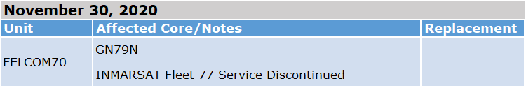

    Service Advisory #2020-10T
    Various Furuno units will be affected by GPS Rollover and other changes set to take place starting in November 2020. The following units may experience GPS positioning errors, incorrect date, or both of these issues. Devices impacted by GPS Rollover will still provide the correct GPS location, if the units are factory reset or power cycled, but the date will remain incorrect. It is recommended these legacy units be considered for replacement with newer comparable unit(s). Please refer to the following tables for more information:
    [​IMG]
    [​IMG]
    [​IMG]
    [​IMG]
    If you have any questions, you may visit our website (www.FurunoUSA.com) and click on "Get Support," then "Ask a Question." You may also contact a Furuno support technician at either our Camas, WA facility, (360) 834-9300 or at our Denton, MD facility, (410) 479-4420.
