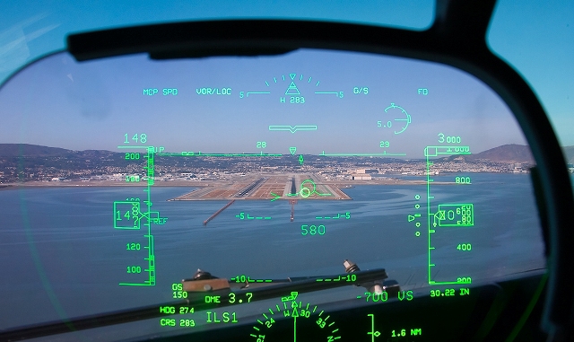

    I do not think, that I am missing the point. You are correct, you can not crosscheck a GPS with a second GPS. If one is in error or has a large CEP, the other one will have the same problem. I am only saying that an intergrated navigation system (both at sea and in the air) is redundent because of its different nav sensors and other inputs. And no operator should rely on a single input for navigation.
    The flight management systems of an airliner will have inputs from GPS, other navaids like VOR, ILS, DME, Marker Beacon, NDB, AHRS (Attitude-Heading-Reference-Sytem) and multiple air data computers. GPS is only one system of it and only one source of information. If the 777 pilot for example had his AP selected to Groundspeed hold (which is based on GPS data), than he might have gone below the minimum approach airspeed, which is based on the aircrafts stall speed at the actual landing weight plus a given safety factor. But the target speed indicator (FMS) and angle of attack indicator should have warrned him visually and by audio, because their input are air data sources. Plus the audio of the radar altimeter must have alerted him about being below glide path.
    As far as I am informed, the pilot did a manual and visual (unbriefed) approach, got behind the aircraft (means, ignored all info and warnings given by the instruments because of stress and lack of proficiency) and had an early touchdown with far to high AOA (nose to high because of low speed), the tail of the aircraft broke off and the big bird got out of control during rollout. It is amazing, how docile airline aircrafts are. A combat jet will kill you, if you do the same thing.
    I do not believe that a ship or an aircraft could be rerouted or taken largely off course, just by spoofing the GPS info. Jamming is possible from far distance, but in that case, there is no GPS signal at all and the operator is informed about the total loss of GPS signals.
    But I agree with you, that little john may end up on a rock, if he drives his boat with his handheld Garmin through the night or thick fog without radar or any other means of navigation. And this even without spoofing, just by a large CEP because of poor reception.
    My American instructor pilot (an old vietnam veteran F-105 pilot) always said to me: "Flying and navigating an aircraft is including all aids, even the forward looking pilot" :)
    B.T.W. This is exactly the excuse, Schettino is waiting for. "I am not guilty, somebody has spoofed the ships GPS". :confused:
    If you look at this picture, which was taken through the headup display of the aircraft during the approach, you might see the amount of info available to the pilot. Only one info in the lower lefthand corner (150 Kts GS) is GPS based.
