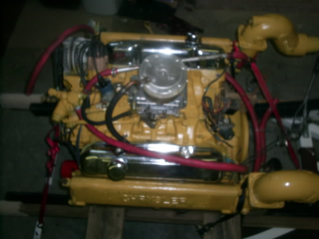

    Getting ready for Spring
    In the process of having both engines rebuilt. Starboard done.
