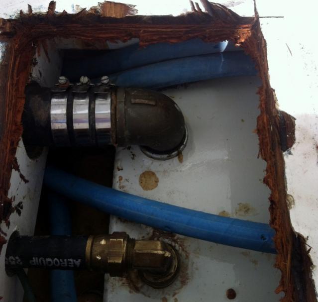

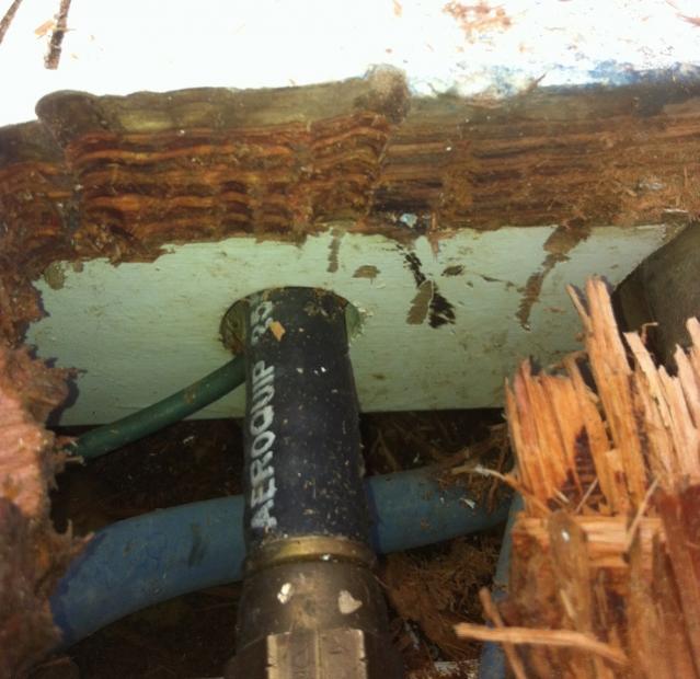

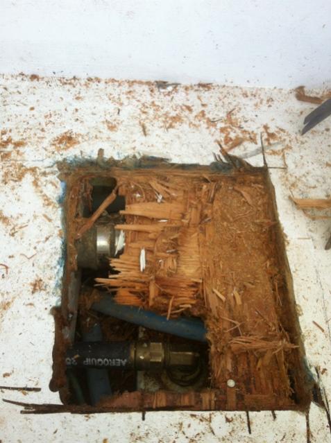

    Today I found the access point to the AFT tank. What bloody joke! Followed the hoses from the back of the ER. Had to drill a few test holes in the storage locker under the entry step in the cockpit to the saloon. Just nicked 2 fuel hoses but not too bad, basically just cut into the rubber outer with a drill. The marine ply was over 2” thick. Then had to carefully cut out the timber floor to access the inlet to the tank. Why would the builder not have had an opening panel? Nuts! BTW, Didn't have time to sand the sides back so it's still a bit rough looking!:eek:
    Anyway, another day, another lesson.

    I'm curious. When you finally got to the space you couldn't get to... how is it that everything in that previously inaccessible space appears to be relatively new?...:)
  18. Marmot
    Marmot Senior Member
    May 20, 2007
    3,300
    9114 S. Central Ave
    Because stuff that lives in clean dry dark places generally holds up pretty well. That is nothing unusual.
