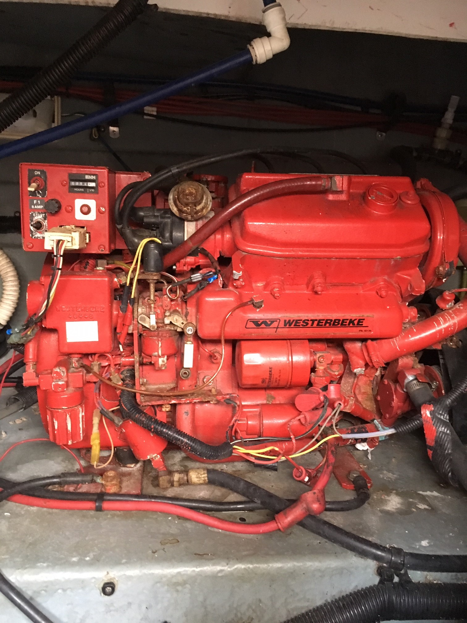

    All good input and I'll keep looking but so far I have not found any other breaker or switch. This picture was taken prior to the rebuild but the configuration is the same.
  5. Capt Ralph
    14,582
    Your breaker in the picture is for the motor.
    Who wired the gen set back up? There are many different strapings at these connects. Don't assume they are the same as when it left the boat. The builder may have changed the strapping for their own style of testing.
