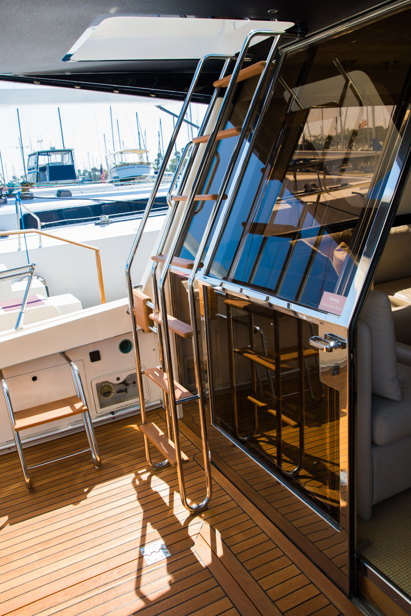

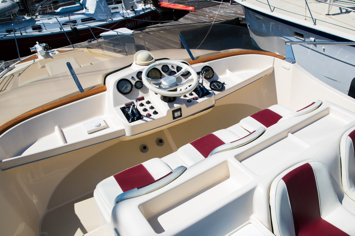

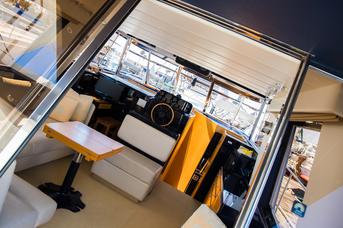

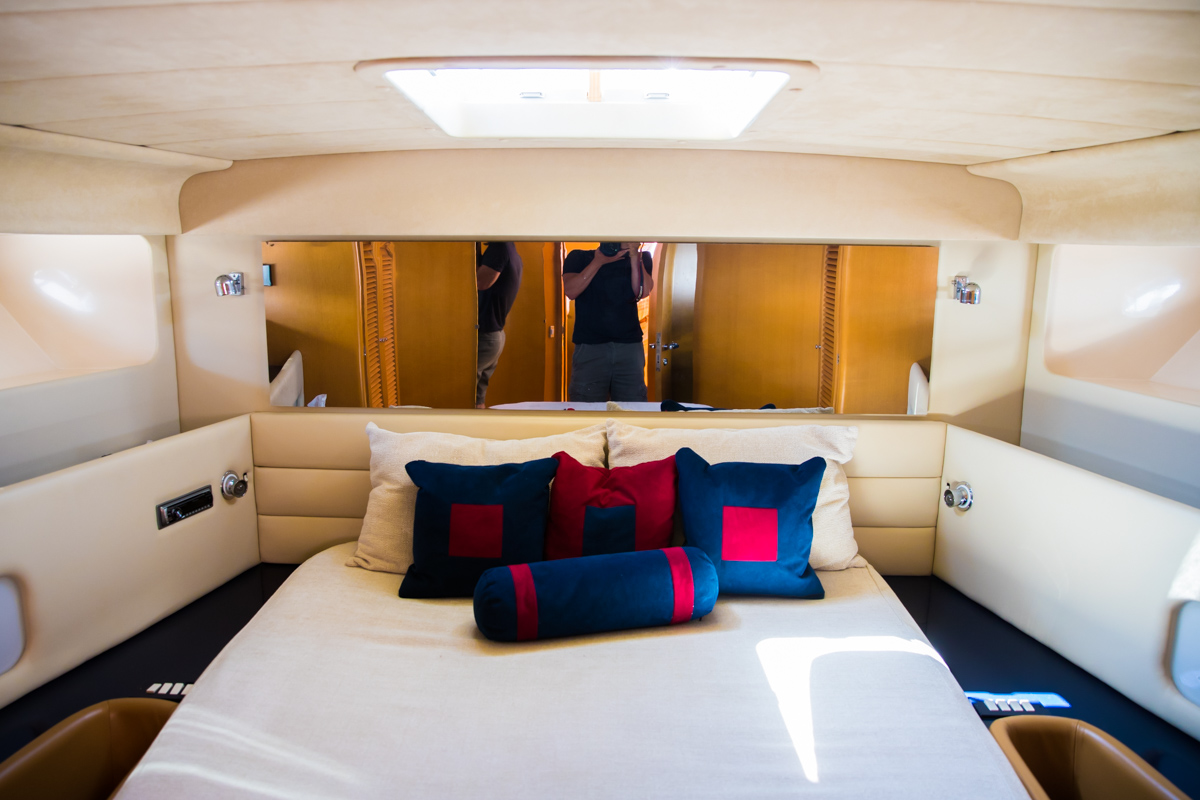

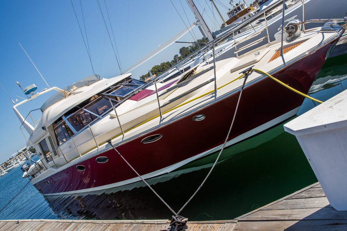

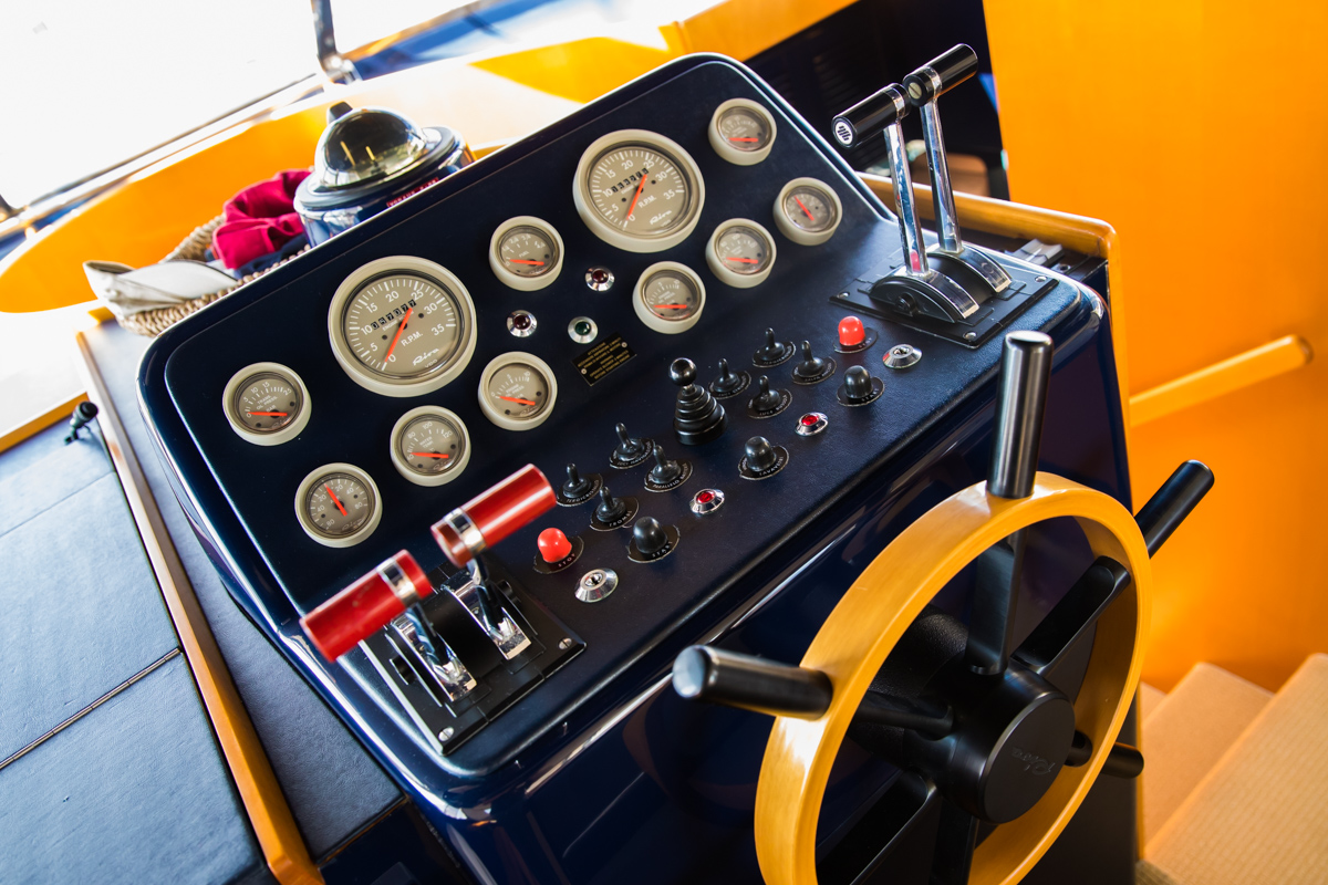

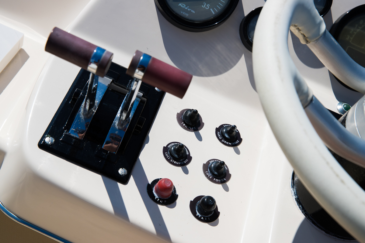

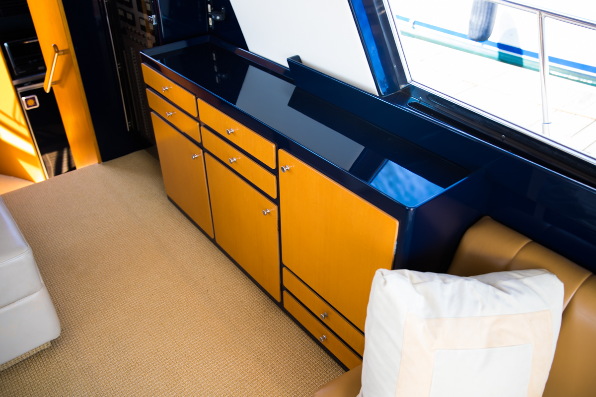

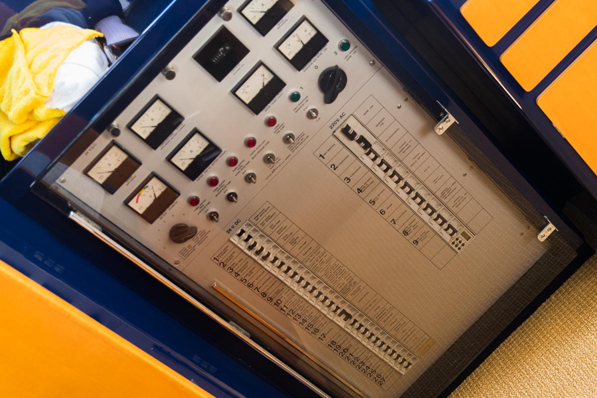

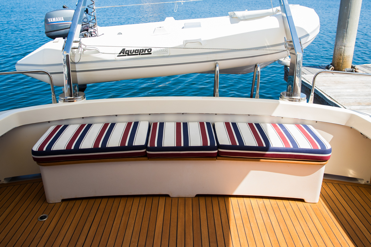

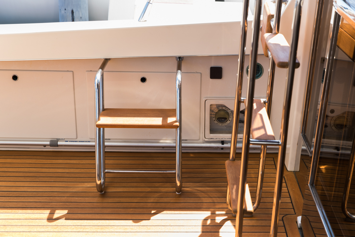

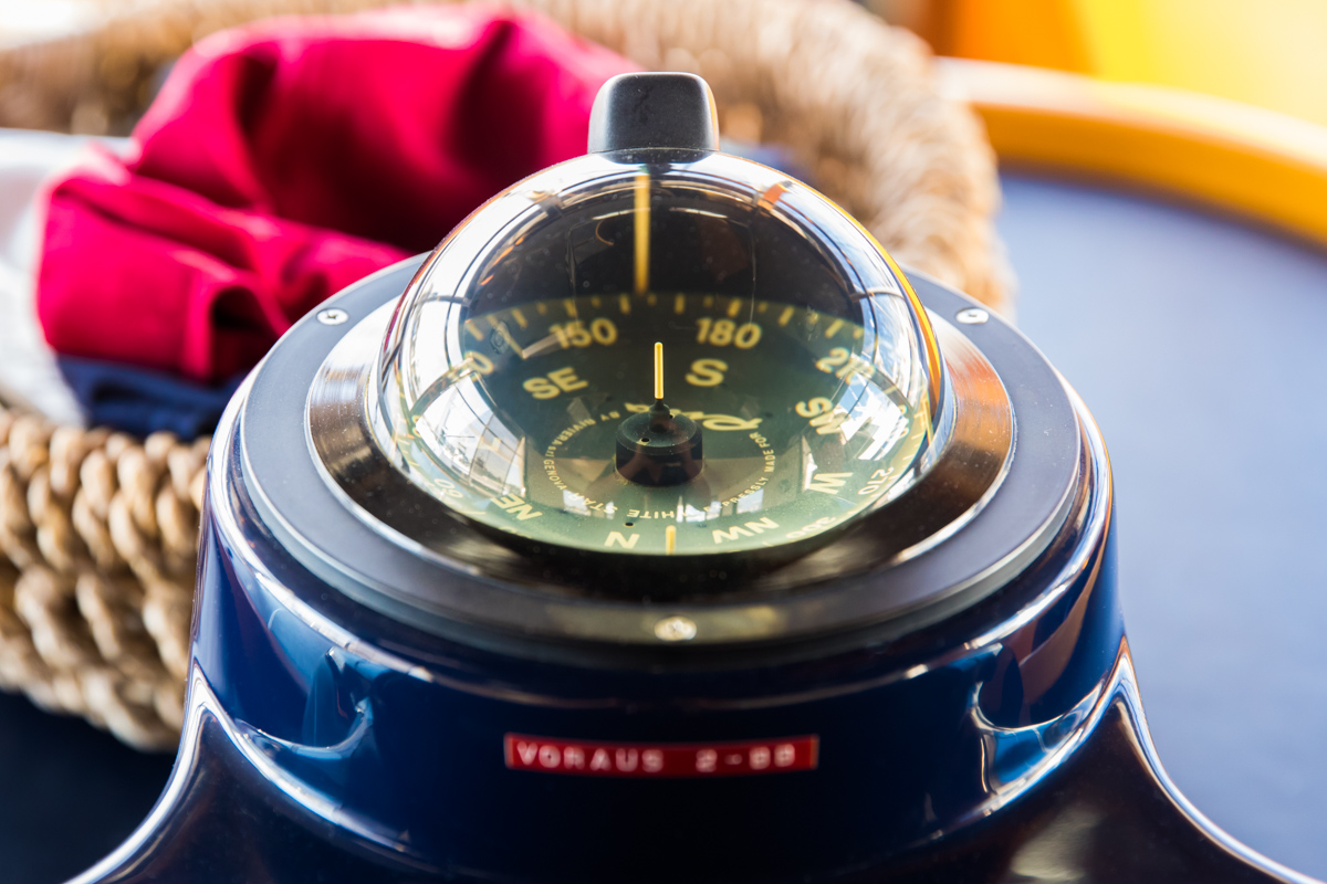

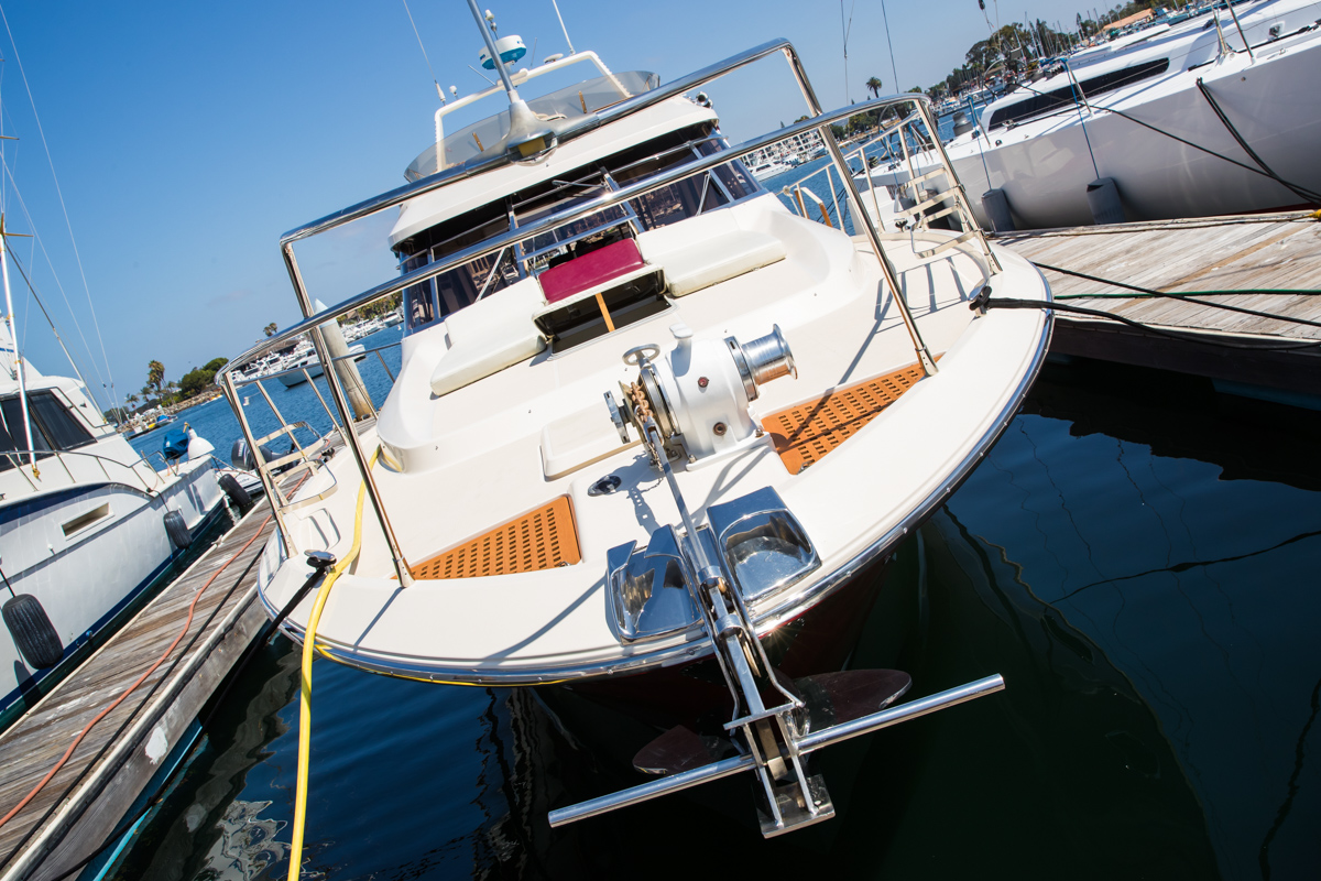

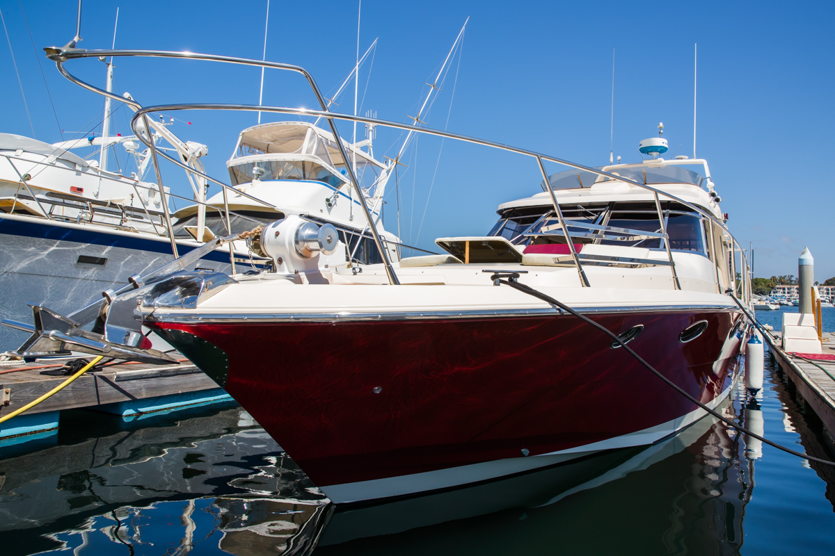

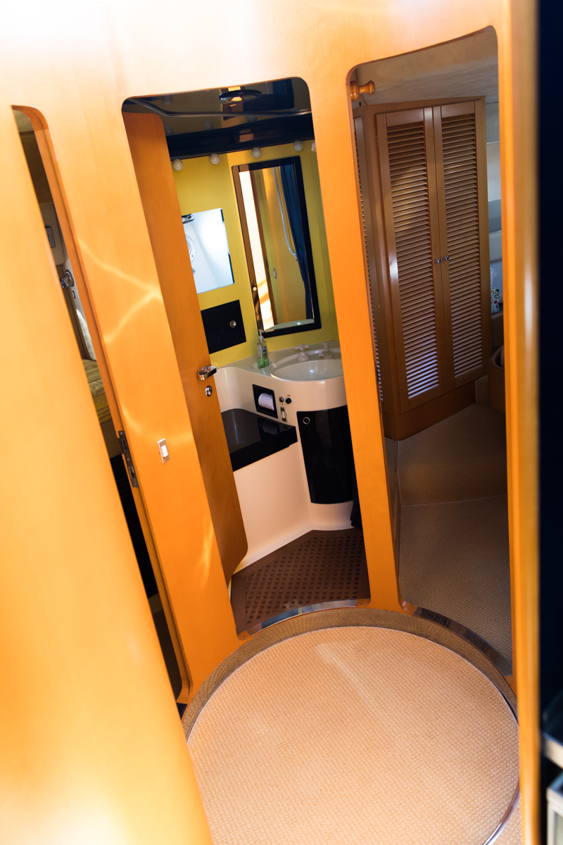

    Amazing. I can't thank you enough. I did check the boat out today and it was in amazing condition for her age. Here are a few pics. Hope the owner doesn't mind I post a few.
    Riva_Superamerica_01.jpg Riva_Superamerica_02.jpg Riva_Superamerica_06.jpg Riva_Superamerica_07.jpg Riva_Superamerica_09.jpg
  14. Adam Murguia
    Adam Murguia New Member
    Aug 7, 2016
    17
    Sausalito, CA
    Riva_Superamerica_10.jpg Riva_Superamerica_11.jpg Riva_Superamerica_12.jpg Riva_Superamerica_14.jpg Riva_Superamerica_15.jpg
  15. Adam Murguia
    Aug 7, 2016
    17
    Sausalito, CA
    Riva_Superamerica_16.jpg Riva_Superamerica_17.jpg Riva_Superamerica_22.jpg Riva_Superamerica_23.jpg Riva_Superamerica_24.jpg
