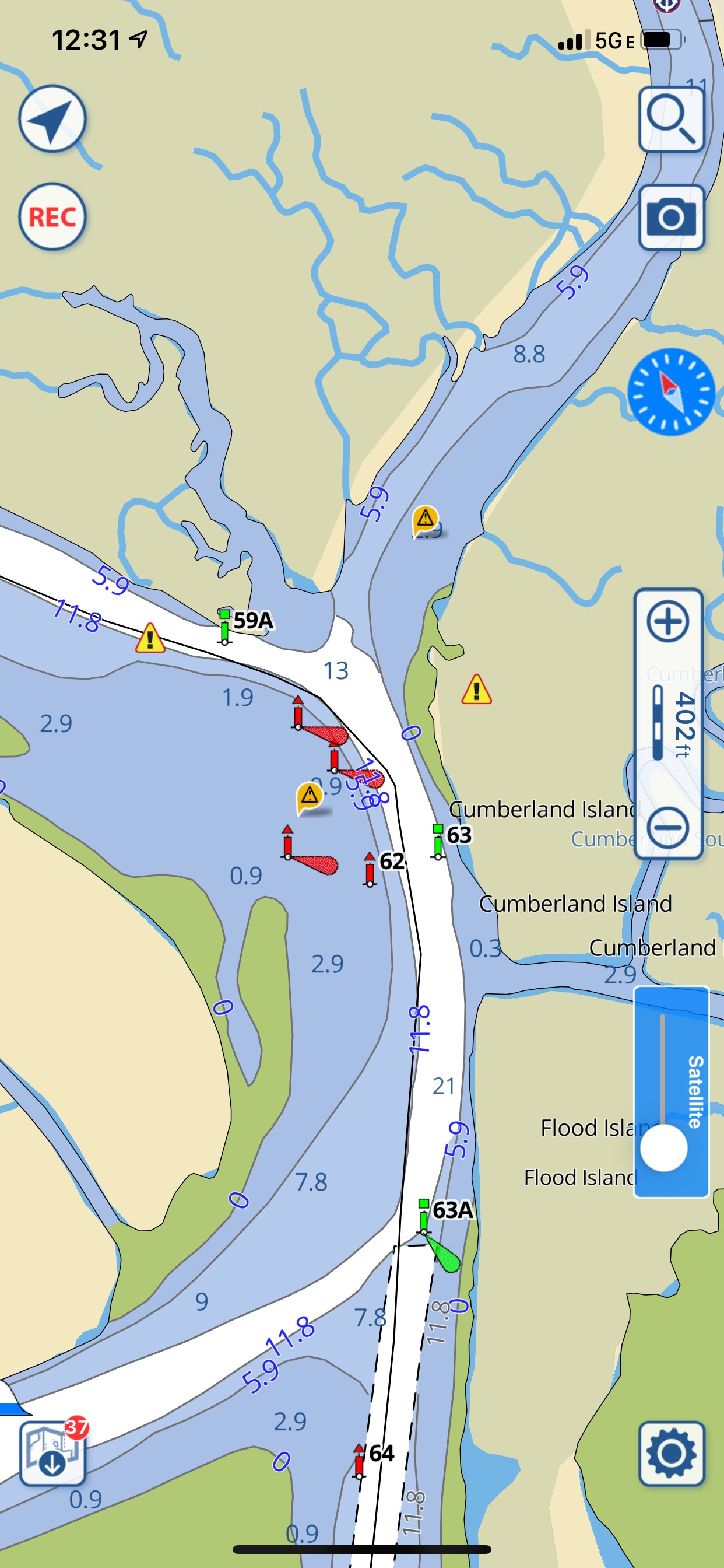

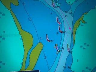

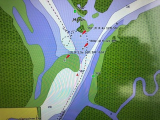

    Two charts of the same area. ICW inside Cumberland Island. Top chart is a Navionics chart. Bottom chart, showing my friends southbound track is an updated Garmin plotter chart.

    That is scary! My understanding is that Garmin uses Navionics data for their charting, so would think the latest Navionics branded chart would have the same information.

    Yea almost cost "my friend" :( some running gear. Garmin charts are way different than Navionics. There must be a way load them with Navionics charts.
    This was a situation that if you followed the markers as you see them you would have been in 10-12' of water, no issues. The Garmins have the markers correct but the white water and swamp are in the wrong spots.

    It s been a while since I ve run that stretch of the ICW but I remember it to be a known Confusing spot. Yes the chart is confusing but it looks like your friend missed 60A and the one just above taking a shortcut to 62A
    whenever you see a number of markers named with a letters after the number, it s a warning sign that you re in a changing area with added buoys or markers

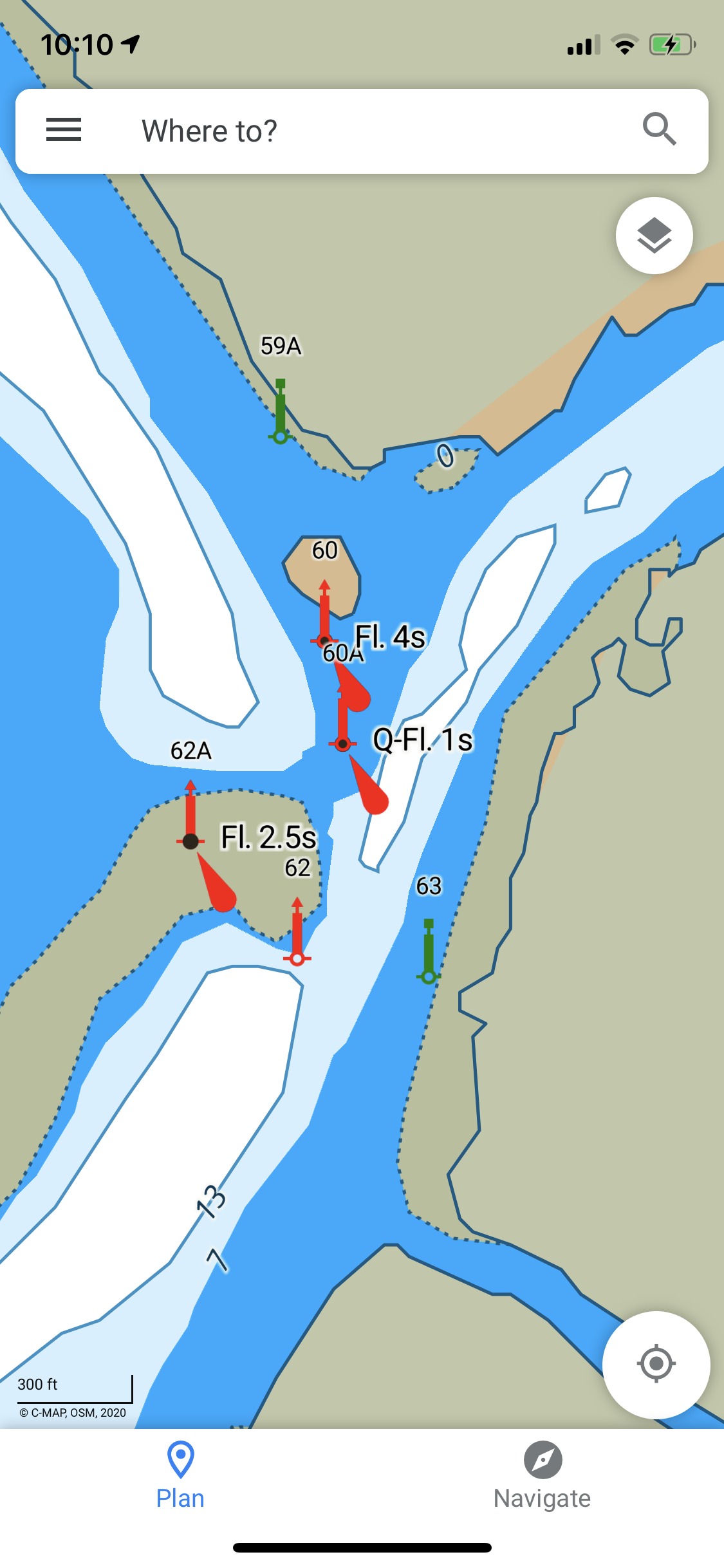

    From my CMap mobile app. I'm assuming the CMap aboard is similar...
