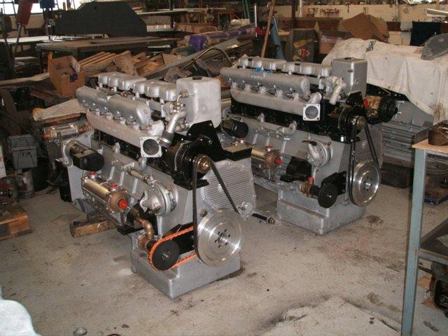

    Hi, it sounds like you got lucky there. I have two 6LXB Gardners in my steel 62ft Van Lent built 1961. When I found her she had two MAN engines, one of which was in poor condition and the other totally seized and so we replaced them both with rebuilt Gardners. They are works of art which run like clockwork and will last for ever. These engines were supplied by Michael Harrison of Garner Marine Engines in the UK, who incidentally travels all of the world to service gardner engines - he also replaced the air cooled exhausts with a water cooled pipes -much better- and he can also supply replacement parts in the unlikely event that becomes necessary. FYI I bought my boat TIKY (ex Alto Volante) a few years ago and I am just coming to the end of a major refit. I should say "rebuild" as the steel hull (and everything within it) was in a seriously bad condition and virtually ready for the scrap heap but she was very beautiful and definitely worth the effort and cost of being brought back to life. (the story, together several pics is documented on yacht forums under "vintage Feadship". What is the name and builder/designer of your boat? can we have pictures? Regards
    David

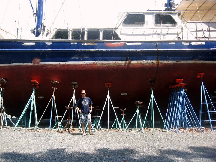

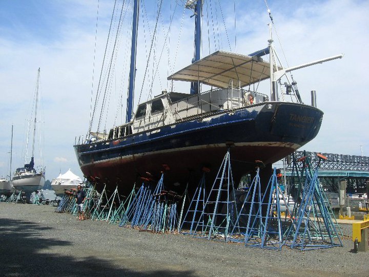

    Luck is on my side with the engines. The bad news is, I didn't get a chance to take too many pictures of the engines themselves. When I go back after a short vacation with my wife, I will take more and post them. I did however take some pictures of the boat. The boat inside had both bathrooms nearly ripped out as well as the galley. The Teak inside looked good, there was some wear in some spots. I am still gathering all the information on the boat "the tangier'. I do know it was a Dutch craftsman who made her and it was used in the 80's and 90's as a luxury passenger boat. For now, that is all I have to go on.
    Thanks for the link for the Manuals!
  4. Capt Ralph
    14,574
    Looks like she has been there a while. All of the yards dry-stands are stored all around her.

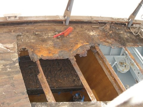

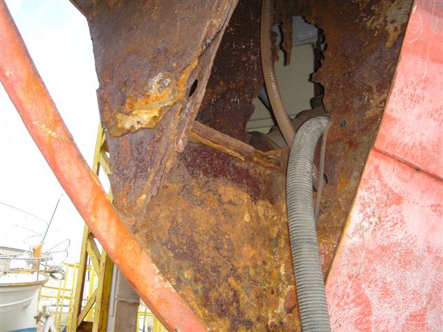

    This is what I found after I discovered my deck was leaking..
  7. K1W1
    7,453
    David, If that photo in Post 25 is your anchor locker you can take some comfort in knowing that you are not alone with a particularly badly rotted out old Feadship.
    Lots of them have had the same sort of repairs required in that area.

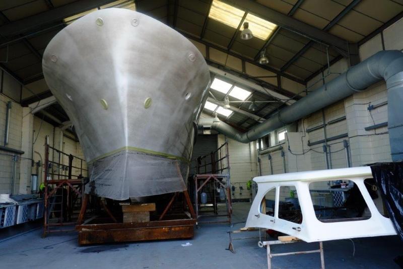

    It is indeed my Feadship anchor locker. The ultrasonics reveal some plate thinness so I told the yard to cut away till they reached solid metal. That's the photo they sent. Presumably as a result of poor drainge and lack ventillation.
    Unfortunately it didn't stop there. The hull was an unsightly patchwork of "doublers" , all in sound condition but clearly concealing some issues beneath them so I had them all removed and the suspect areas cut out and replaced - all 30 sq mts of it!
    Then we started on the deck...all the old worn original teak decking removed to reveal a lattice of rusted deck structure beneath. Then a new interior fitted together with all new wiring and plumbing systems ....ten we have shaft alignment issues to sort out that required some surgery to the A brackets.......and so on.....
    Coming to the end of it now, I hope . Here she is in the paint shop (shes not in a metallic colour as the pic suggests - its sacrificial thin coat of black that gets sanded off to reveal low spots, before being sprayed with top coatings "off white")

    It has been there for quite some time with minor work done. About 5 years ago there was a plate put towards her hull because of wear/thinness. I will be going done to see her this weekend to take some more pics and see if she is even worth getting involved with for the next few years :) but boy oh boy do I love those gardners!

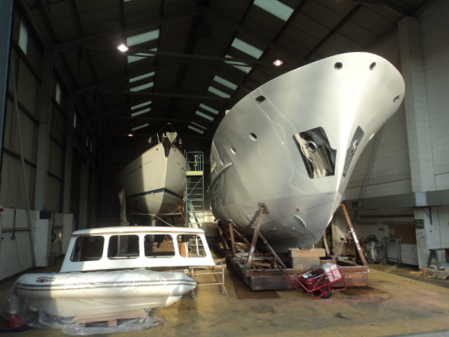

  13. david_japp
    david_japp Senior Member
    Feb 7, 2005
    369
    london
    Feadship TIKY ex ALTO VOLANTE
    Here she is (finally) in Awlgrip "Off White" ...still a way to go though
