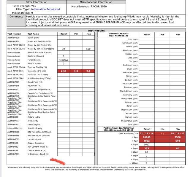

    Had a fuel sample sent to a lab and it came back with elevated viscosity at 2.5. Acceptable is 1.3 to 2.4. Lab notes it is usually the result of mixing nr 1 and nr 2 diesel.
    I am assuming that marine diesel is nr 1, correct?
    also has elevated particle count so we ll have to keep an eye on the filter. Will also run the fuel thru the (finally rebuilt) Alfa Laval.

    Can't you just buy a viscosity cup and check it yourself ?
  6. Capt J
    14,435
    Your engines were built during a time when #2 diesel was the standard. I wouldn't worry about it.

    The MTU tech who just did the in frame on the port 16V2000 isnt too worried about it either. I just wonder how one would get nr 2 diesel in the boat since marine diesel appear to be nr 1. Trying to save a buck getting cheap diesel delivered? Have about 2500 gallons left :)
    just transfered 1000 gal from aux tank thru the Alfa Laval, then will polish the main tank.
