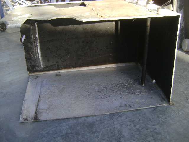

    I am wondering if anyone has had, or has heard of issues with replacing the center fuel tank on oceans... particularly the 63' ??
    My 63' is in the boat yard right now having the center tank replaced. When we finally got it opened up and cut out, we found out that the pickup tube was made of stainless steel, and the tank is aluminum. There was a lot of pitting or 'pin holing' directly below the tube, which we believe was cause from galvanization or form of electrolysis jumping from the tube to the bottom of the tank.
    Has anyone else had similar issues. I believe this is a manufacturer issue, and would love feed back.

    The tank is flat, rectangle. 300 gallon tank.
    The tube ends approx. 3" from bottom of tank. the pitting is isolated to just that area, no other area in the tank.
    There are not signs the tank has ever had water in it, and it is not likely as this is the MAIN center tank. All outboard tanks gravity feed to this one, and this is the one the engines pull from.... so this tank would always be full of diesel.
    The outside of the tank was virtually like new... no signs whatsoever of water or corrosion.
    The boat yard agrees they think this is a form of electrolysis.

    Well... I am not sure how to answer this one... but obviously bad enough to create a pin hole effect and leak significant amount of diesel.
    see attached for pic
  6. Capt Ralph
    12,649
    That's corrosion, not galvanic erosion.
    The pickup tube is bonded to the tank by it's pipe connection.
    Chemicals, decay, water and/or more would cause that damage and leave the tank bottom clean without diesel stains.
  7. Capt J
    14,432
    Getting 20+ years out of an Aluminum tank that sits a few inches above bilge water is very good. I'd highly consider replacing the saddle tanks at the same time.

    Yep. Notice how clean and pit free it is in the immediate area around the pickup? That's because the higher relative velocity of fuel (because the pickup is so darn close to the bottom) in that area did not allow water to sit on the bottom and create corrosion cells. The general shape, size, and location of the corrosion shows where water migrated toward the pickup and collected. That water fed the bacteria that produced the waste products that ate the aluminum.

    To me it looks like a tiny bit of saltwater is getting in through the vents or the fills the way the metal is pitted. That is where it is going to end up from all of the tanks and the other tanks shouldn't have water issues. The 63' Ocean has a large saddle tank on the outbound side of each engine, and both of those tanks have a hose at the bottom that gravity feed into this tank which is in the ER aisle underneath the floor. The top of the tank in question, is below the height of the bottom of the saddles that feed it and everything draws fuel off of this tank.

    I understand your thoughts about water creating the corrosion... but water would not accumulate there as this is the main pickup for the engines. We use the boat frequently, engines get run every week whether we use the boat or not. We have never had any water in the Racores. I don't see how water could build up there as it would be sucked up and ran through engines.
    As a side note, the yard did clean up that area below with acid as they were trying to find the pin holes... possibly why it looks so clean under the pickup tube.
    The outside bottom of the tank (exposed to the bilge) was in perfect shape... paint even still looked clean... so we don't believe it was sitting in bilge water, and there was no corrosion anywhere else.
  12. K1W1
    7,388
    Ferrous material from drilling and cutting that is not removed can also cause pitting when in contact with the tiniest bit of water.
  13. Capt Ralph
    12,649
    Your the original owner? It could have suffered the blunt of damage years ago and once it starts, it really never goes away (corrosion).

    Excellent point. Aluminum boat owners should be very careful about wire clippings and drill swarf in the bilges.
  15. Capt J
    14,432
    It does not take very much water to cause that damage over a great number of years......Basically 3 tablespoonfuls is all that would take over years of time, the pickup would never pick that up since it is much higher. Since fuel floats, the water always stays at the bottom, there is also not a big surge or movement of fuel in that tank because the saddles keep it 100% full all of the time, unless you're below the last 300 gallons of capacity on the entire boat.
    And also the comments about pieces from drilling the tank is a valid point. On the 63' Ocean I managed, Ocean drilled the 1/2" hole for the pickup and dropped the bung in the tank. It floated around in that tank for 19 years until it got caught in the very same pickup it was drilled for. We had awesome water pressure for 2 seconds, then it would just barely trickle (it was sucking through the pilot hole), then we inspected the pump and the intake hose was totally collapsed, we tried to blow the pickup out and couldn't and pulled it out and found the piece stuck in it, 19 years later.

    Interesting about the shavings. My captain said there were particles in the tank that resembled metal shavings.
