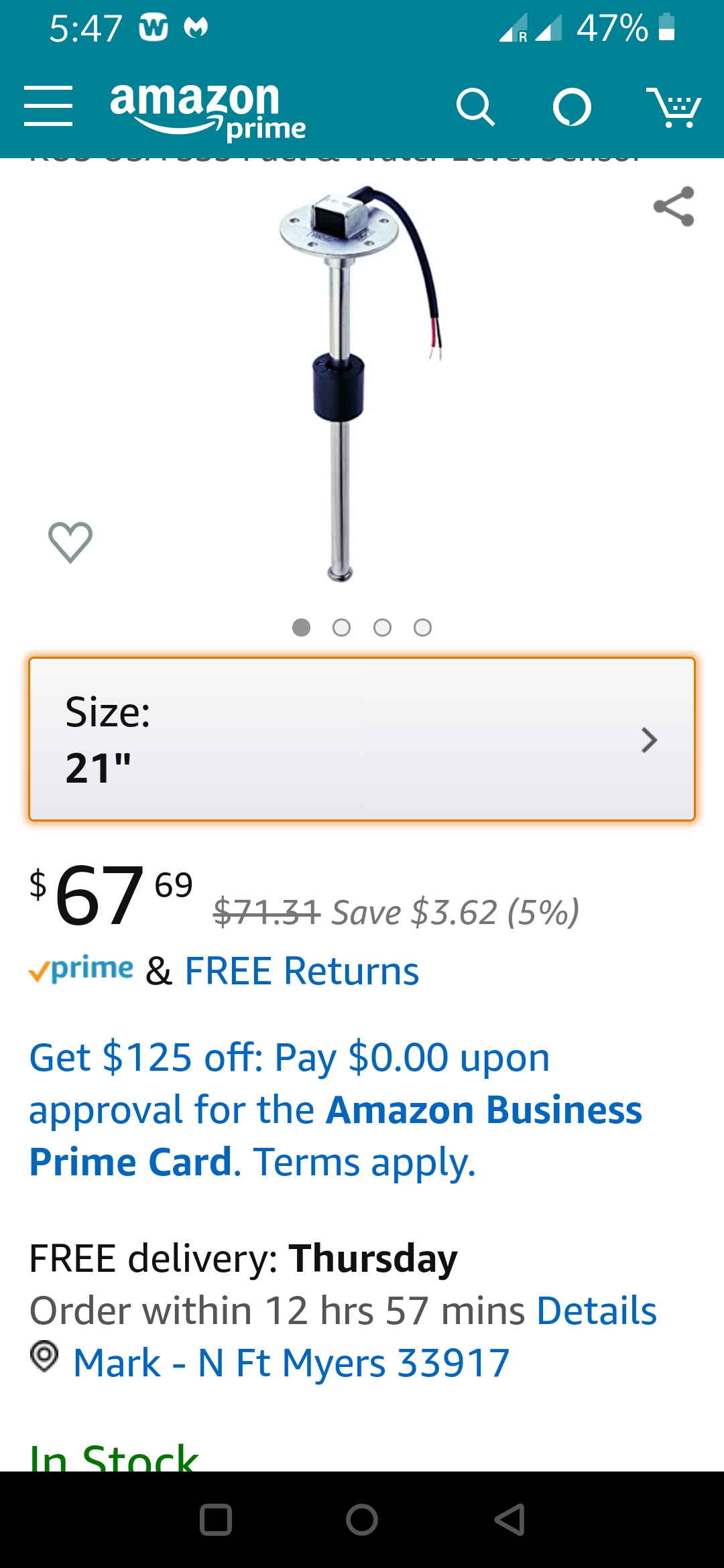

    Here's an example.
  5. Capt J
    14,435
    That's a KUZ sender......you need the mounting pattern 5 screw or threaded flange AND you need to know the OHMS for the gauge...….they are made in virtually any length you need, and the 3 different OHMS. You can test the sender by connecting both wires together at the sender, the guage should be pegged on full.
