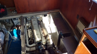

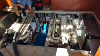

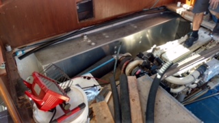

  8. Help
    Help New Member
    Jun 5, 2016
    5
    West coast
    Here are a couple of over view photos, the entire floor and sub structure has been removed to facilitate the tank removal and installation.

    When you remove the starboard tank where did you cut it to get it out
  10. Help
    Help New Member
    Jun 5, 2016
    5
    West coast
    Basically it was cut into quarters, with the top removed the interior was cleaned to minimize a mess when the lower portion was cut in half. As you can see the new tanks were sized so they could be installed and placed after they were fabricated.
