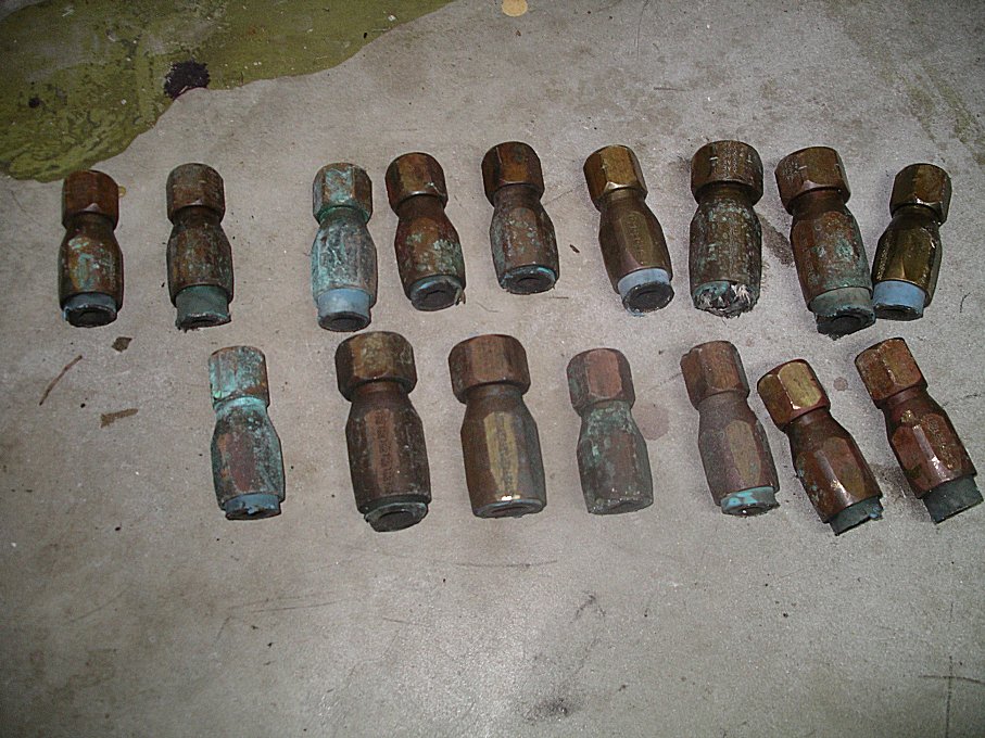

    I just got 16 of the old fuel line ends. Mechanic said he will bring the other 14 on Wednesday after they arrive at the hydraulic supply. If you send me your zip code I can provide your your cost to ship. Also a reminder. These are crimp on type so no idea why you would want them.

    Those are not crimp on.
    Those are reusable 3 piece ends.

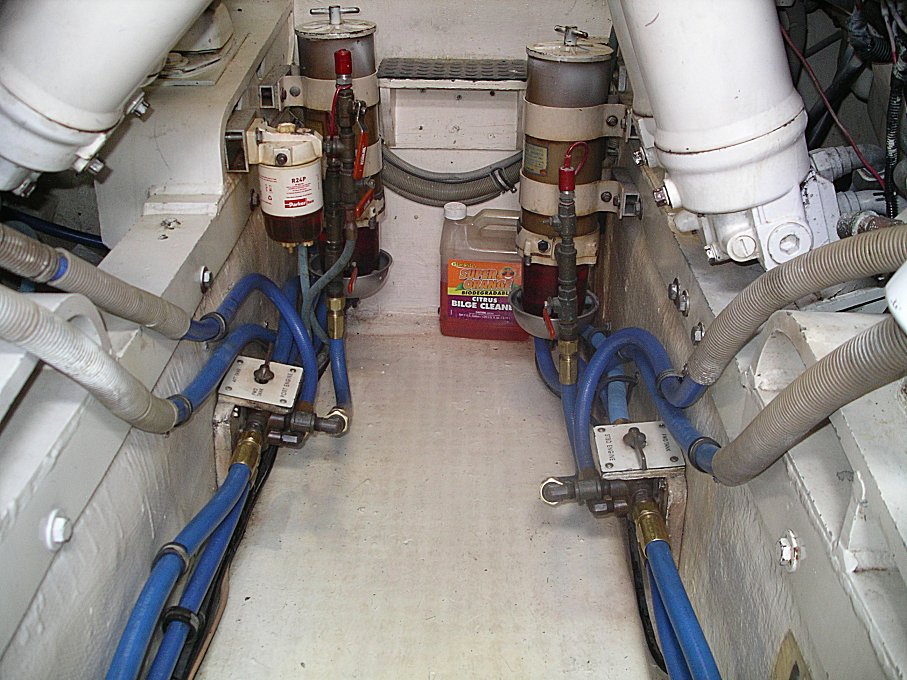

    Mechanic just confirmed you're correct. He said the hose supply would not be responsible for a leak if they didn't use all new crimp on ones. O well, I'll let you know soon as he brings me the rest of them. The new blue hoses say Parker and Coast Guard Approved and a nice blue, and unlike the old hoses that were stiff as boards these nice and flexible.

    This is a good CYA for the hose shop.
    I do understand their liability and warranties on new hose assemblies. I also understand profit margins and business pressures.
    The used hose fittings are a PIA to take apart and clean up. Requires at least 6 oz of hooch some raining afternoon.
    Half of the stuff in your picture will be scrapped. Amazing how many cracks and flaws I find in the lil pieces during inspections.
    Some lil nugget in the back of a real hose shop can not make a pay check this way, but I'm not working for profit. Just tinkering on some prototype fuel polish system and keeping up a mix/match inventory.
    Give your new hoses a few years sitting in place. Out of boredom, they will get stiff also.

    Made a lot of progress today. Won't be back to finish till Thurs. He was talking about retiring and moving to Costa Rica.
