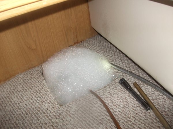

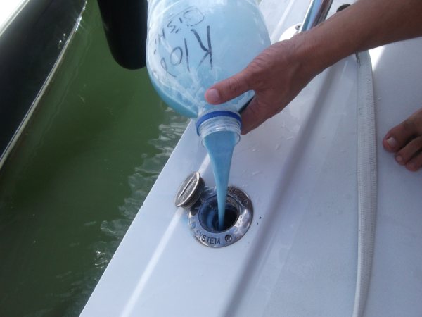

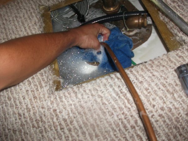

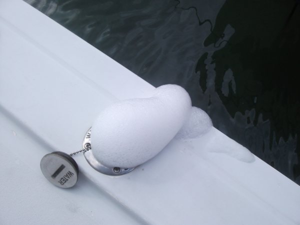

    My dear friends...finnally I decided to clean my tanks with a guys specialized in cleanning fuel tanks....they use a bunch of producst from some kind of dust detergent (i think it was soap...jejeje and clorox) they open the tanks directly on the senders and place an air hose inside...pictures attached....
    So far I have fill twice the tanks and still have a little smeel of soap in the water....will see after a couple fills more....

    After filling the tanks almost 9 times I can tell, that smeels is finnaly going (still there....but is is almost imperceptible) .......

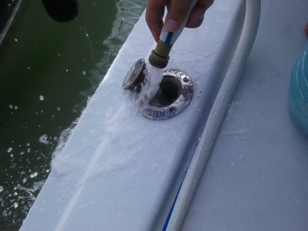

    :) Sorry about that.... after cleanning the thanks (one time only) I fill the tanks with clean water...navigate rough seas......waste all the water....fill the tank again (I have done this 9 times)....
    I am going to fill them with one gallon of alcohol per each 50 gallons of the capacity, to see if I can kill that final smeel I feel
