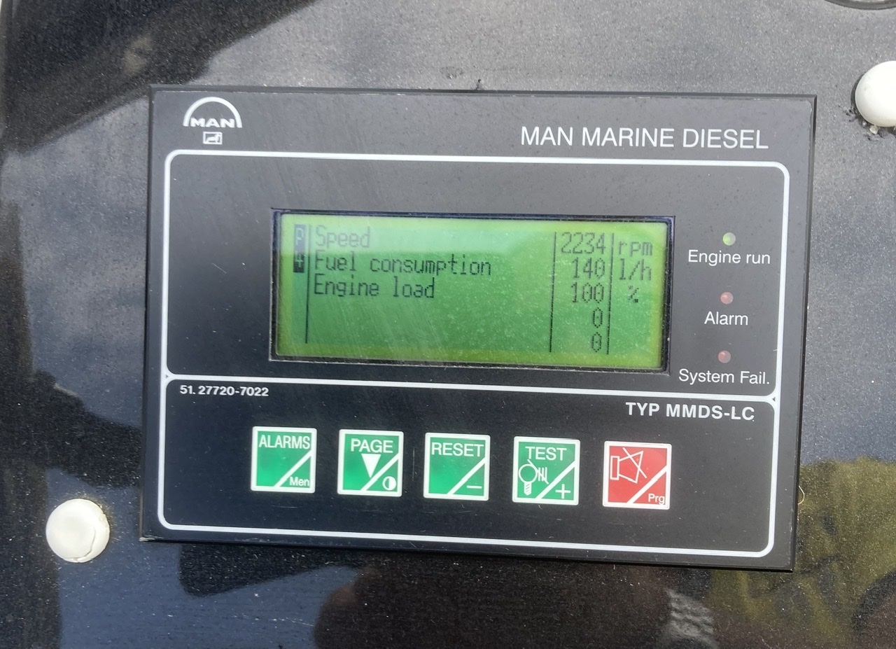

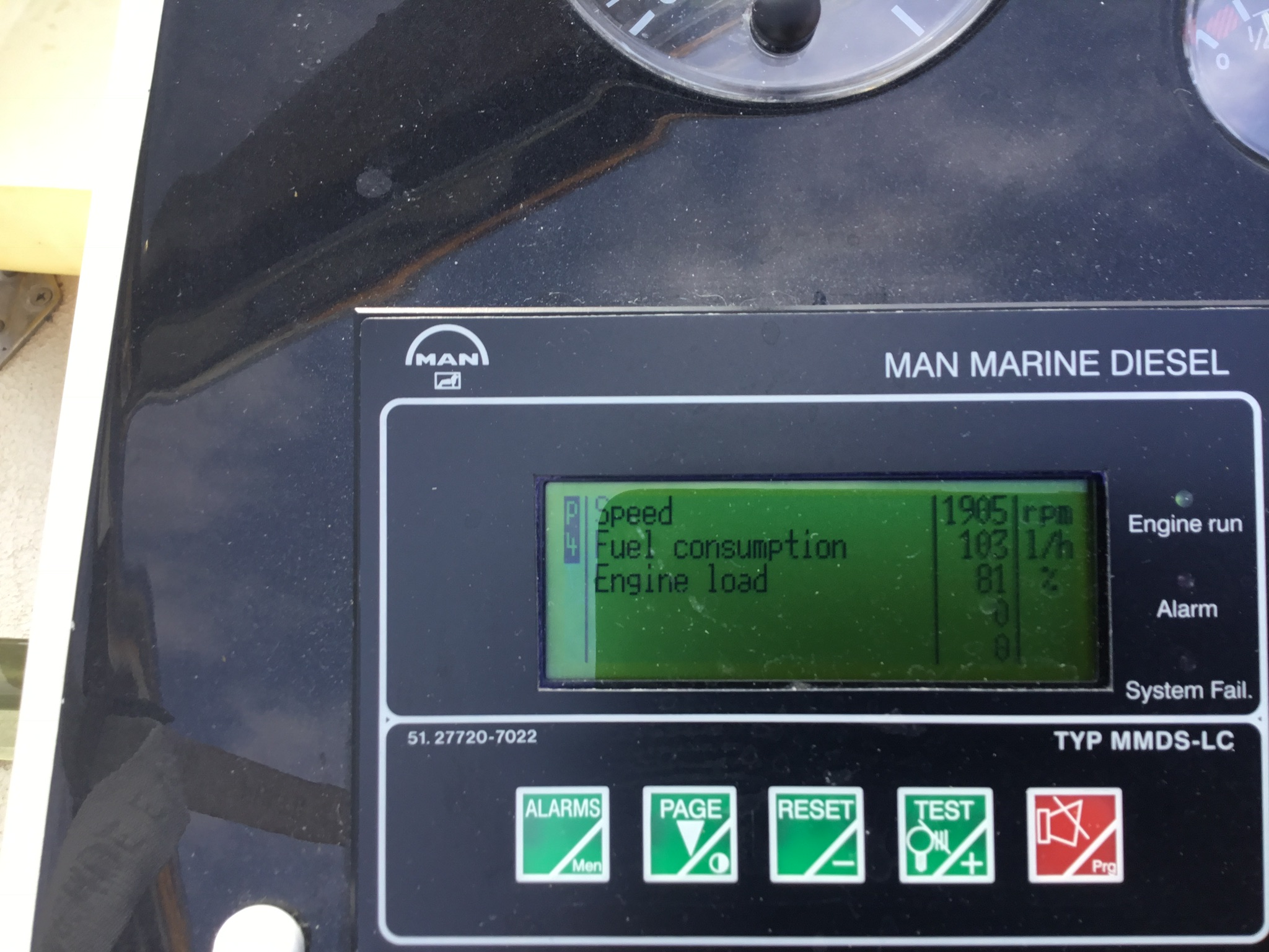

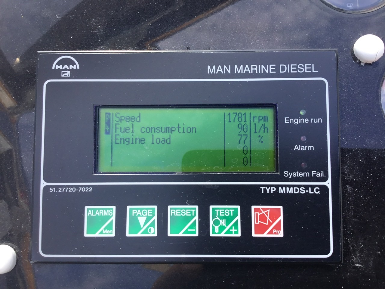

    Repost of earlier pics to save flicking pages .
    From 1 to pic 2 , see the 4% rise of rpm the 124 rpm increase and we go up 4 % load .But fuel rises 11 % …….it’s just at the beginning of that ski jump slope ( going upwards folks )
    Indeed illustrates the “ sweet spot “ if such a thing exists….for my boat the balance of Hp , hull speed , around 30 knots and economy and arguably reliability/ longevity of the now 20 y old motors .It feel so right too FWIW .It positioned at the bottom flat end of that ski jump slope .
    0244996B-B94B-4902-B851-8E304FE7825A.jpeg A06D1AD0-74F6-47EC-90FA-D1C6C78A5EF4.jpeg
    Pic 2 to pic 3 we ascend the steep slope to the top , climb up that slope in ski jumping language to where the guy sits before he pushes off .
    Another 15 % rpm rise to the end and loads increased by 19 % but fuel burn in simple maths 37 - well near enough double the load rise for sake of argument .
    So if the smaller lighter lower wetted area hull of the Cabo ( and mine compared to yours sacrificing 100 Hp and 4 litres of cubes and 2 jugs per side ) is set as Capt J says at 80 % load ……..then how do you know yours is not on that steeper incline of the ski jump incline for fuel burn ?
    It’s slower sure .But you don’t know where the bottom area the area that flattens out is on the slope without load gauges for meaningfully comparable burn figures.
    As said from what you quote those numbers how ever well intended dont add up , fit in to the numbers folks like myself, Capt J and probably many others see on there screens every day .
    There’s an error a miscalculation, a miss calibration on your behalf.
    Btw that’s does not stop me reading your posts or reply ing to them .
