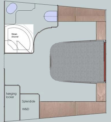

    The nasty winter we've been having in the Mid-Atlantic area has given me lots of time to get some head-scratchin' in about what's coming next and how best to get 'er done.
    First order of business once the weather gets favorable is to make the hatch in the salon roof disappear. I've been prepping braces and mahogany lumber to scarf the frames back together and have tons of marine ply and fiberglass fixin's, so it's just a matter of getting favorable weather. Of course, we'll have to move appliances in before the roof gets sealed up for good. All in due time...
    The missus and I are still debating best approaches for the galley, but it's to the point where general concepts are agreed upon. She's finally accepted the fact that I'm the engineer and she's the designer, which means she's the "boss" but I have god-mode as an option when push comes to shove.
    Fortunately, there's been no pushing or shoving...yet.

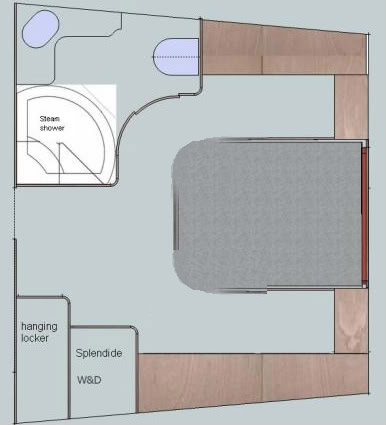

    Anyway, we've pretty much wrapped up the design phase for the aft stateroom. Here's what we have in mind:

    If you want to do big tube shower, Spartan Industries makes them for yachts.. sizes vary.

    a thought on your aft cabin design. Berths, and in particular double berths, dont need to be full width at the foot. Have you considered rounding off the forward corners so as to follow the curve of the head compartment? even better, why not make the berth taper at the forward end - it doesn't change the size of the bed (or the comfort of those using it) and because you then see more floor space, it makes the whole cabin look bigger and less cramped, especially between the foot and the head door. You can go one further by having a recess at floor level, all around the bed, which makes a dramatic difference to the overall look of the cabin

    David, I see what you mean about the bed. But the fuel tank is rectangular and just happens to have the same perimeter dimensions as a standard queen-size mattress. Lining up the pros on one side and the cons on the other, I think it would ultimately come down to a coin toss as to which approach is best. Either way, the tank is already installed so the point is moot.
    Why didn't you make that suggestion back in '08, before I had the tank fabricated??? lol :p

    amending the tank won't be difficult - a competant fabricator could do it in situ in a couple of hours and for the loss of a gallon or 2 of fuel you'd have a vastly improved aft cabin.

    Actually, David, it would be an enormous job because the tank is fitted to a cradle. Modifying the tank would mean also modifying the cradle. The interior of the boat has also been barrier coated, so then there'd be more epoxy work after the welding was done. And cutting off part of this brand new tank to gain a meaningful amount of not particularly useful interior space in what is essentially a walkway around a bed would mean the loss of roughly 50 gallons of fuel capacity, according to the volume calculator that's built in to google sketchup. Then there are the floors, which are already built around the rectangular cradle/tank assembly...
    Like I said, there are pros and cons. But at this stage of the resto, I wouldn't even consider going back and tearing into work that's been done to a perfectly satisfactory result. "Vastly improved," like beauty, is perhaps in the eye of the beholder.
