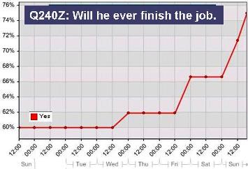

  10. alloyed2sea
    alloyed2sea Moderator
    Jan 28, 2004
    871
    Alex, VA
    Betting odds,...
    ..., on your actually finishing this gargantuan task just took a big jump up. Fortunately, I made my wager early (justknewyoucoulddoit).
    Keep up the good work, I've got alot of dough riding on it (nevermindthenotsogoodstateofmycreditdefaultswaps).
    Cheers!
    Eric
