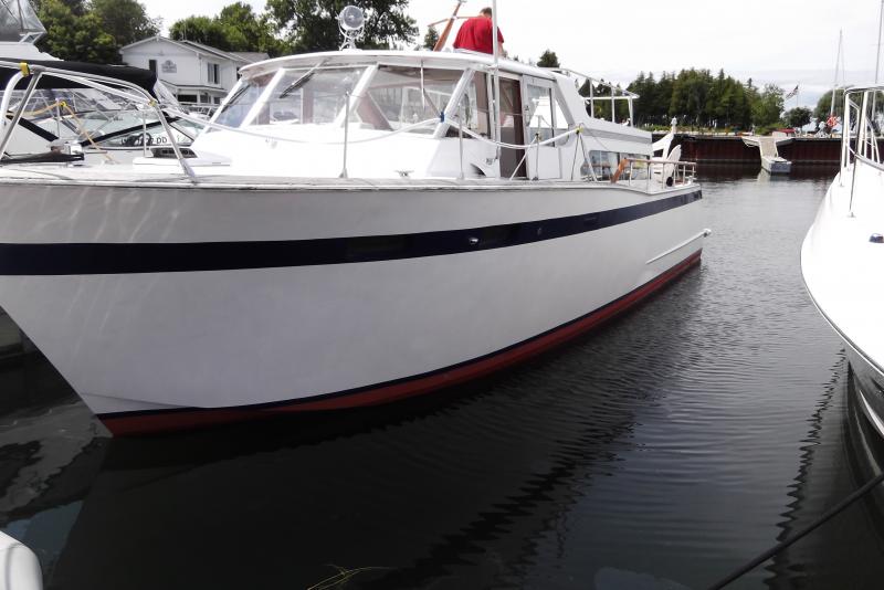

    The Offshore in question.

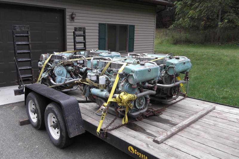

    I hope you bought all 4 on that trailer.

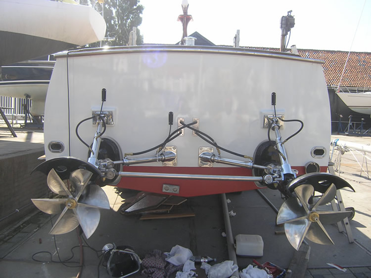

    I am a big fan of Arneson Drives. Those diesels will not push them for more than a few minutes.
