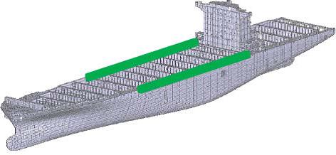

    The Ship was built using YP47 steel (yield stress: 460 N/mm2) in the hatch coaming to mitigate against toughness degradation that could occur when using extra thickness plates.
    I don't see how anyone can attribute this loss to high tensile steel - that was not where the failure began and it was the last part to break.
    https://www.mhi.co.jp/technology/review/pdf/e443/e443028.pdf
    The green parts are where HTS was used. Those were the last parts holding the ship together before the final break.

    Page 4 of the Japanese article clearly says:
    Overview
    Results of Investigation
    The Ship experienced hogging (convex deformations in the longitudinal direction), causing the ship’s midship to fracture. According to observation of the progression following the outbreak of the accident,the upper deck area was the last part to fracture. From this, it can be assumed that the crack
    which trigged the fracture began below the waterline in the bottom part of the ship’s hull and then progressed upwards along the side of the ship. The fracture is believed to have originated in the bottom shell plates of No.6 Cargo Hold
