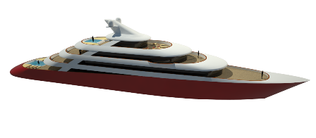

  1. dorvieto
    dorvieto New Member
    Jun 9, 2009
    23

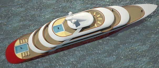

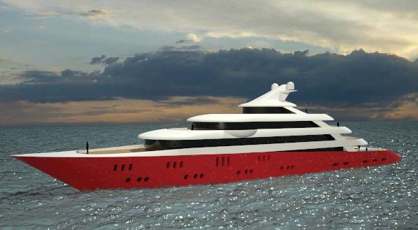

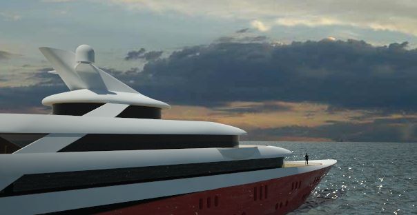

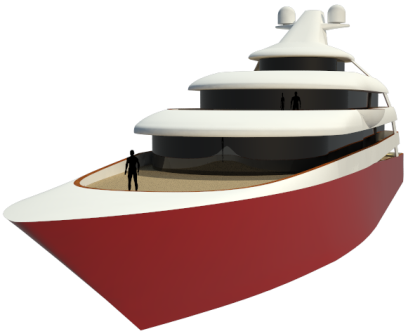

    I am working on my first yacht design and am seeking comments/criticism about my progress thus far. I have a background in naval architecture but am seeking to become more fluent in 3D modeling and design. I am using Rhino for modeling and Vray for rendering. I only just got Vray and am learning it as I go, so the renderings are crude right now but should improve as I continue. The model still needs a lot of work, and much more detail must be added, but I feel its at a point where one could get the basic idea just fine. Any comments (good or bad) are welcome.
    Thanks!

    Properly Sized Renderings
    Sorry for the overly large pictures I posted originally. Here are some resized pictures. Comments/criticism would be greatly appreciated!

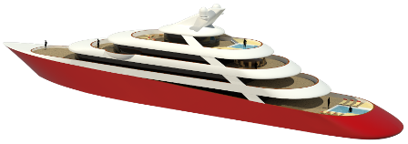

  6. dorvieto
    dorvieto New Member
    Jun 9, 2009
    23
    More Renderings
    Some more renderings of the same design...Starting to get the hang of the Vray basics, hopefully more progress to show soon.

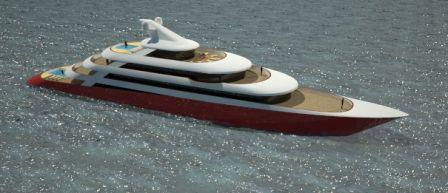

  7. dorvieto
    dorvieto New Member
    Jun 9, 2009
    23

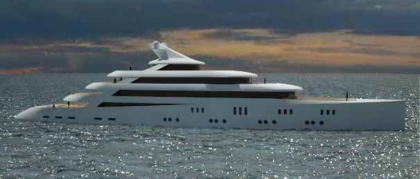

    Rendering with better water
    Here's another rendering with better looking water...I've been playing with the texture mapping quite a bit and am starting to see some improvement. All comments, positive or negative, are greatly appreciated. I need as much feedback as I can get to refine this design. Thanks!

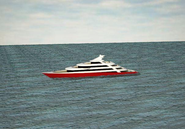

  8. dorvieto
    dorvieto New Member
    Jun 9, 2009
    23

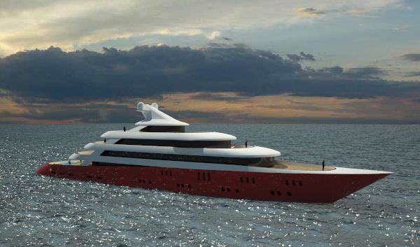

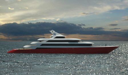

    Updated Rendering with Sky
    Here is another rendering with sky included...Comments please!

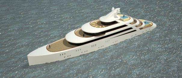

  9. dorvieto
    dorvieto New Member
    Jun 9, 2009
    23

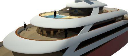

    Updated with portholes
    Design now includes portholes...railings and mooring gear to come next. Any feedback would be very helpful!

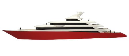

  10. Kevin
    3,099
    Something about the stern doesn't sit right with me... it's as if it can't decide what it wants to be. The taper looks too "in between"... either step down closer to the water level, or maintain a more even proportion from bow to stern.
    (But that's just my humble opinion, of course...)
  11. dorvieto
    dorvieto New Member
    Jun 9, 2009
    23
    Stern
    I think I see what you mean. My intention was to continue the curve that defines the edges of the decks all the way to the waterline. I have been playing with the stern quite a bit, mostly modeling different options like stairs leading to a beach club area. I should have some updated options within the next day or two. Thanks for your comments! Any opinions on the design and/or renderings in general?

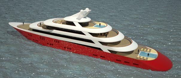

    More Updated Renderings
    Some more updated renderings for comments...

    A couple more renderings
    A couple more renderings for comments...

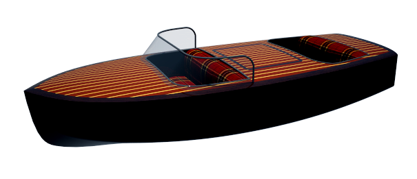

  20. dorvieto
    dorvieto New Member
    Jun 9, 2009
    23

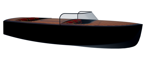

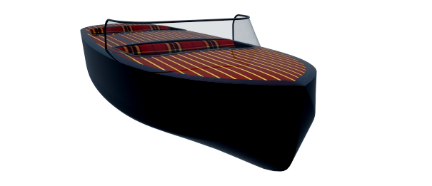

    Possible Tender?
