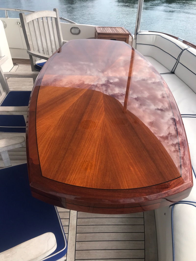

    Not to derail but I haven't seen the epoxy wipe method you described used before and will have to give it a try. Most of us buildup multiple coats of epoxy until the surface is fair and flat then topcoat with the LPU's for UV protection, the thinking is the more epoxy the better for damage tolerance and the LPU is just for UV. This toe rail for a little boat got 10 coats of epoxy and about 20 or so of Alexseal UV clear which is the same treatment transoms, cap rails and trim gets. 27858369_1668719366519942_505241573147826177_n (480x640).jpg

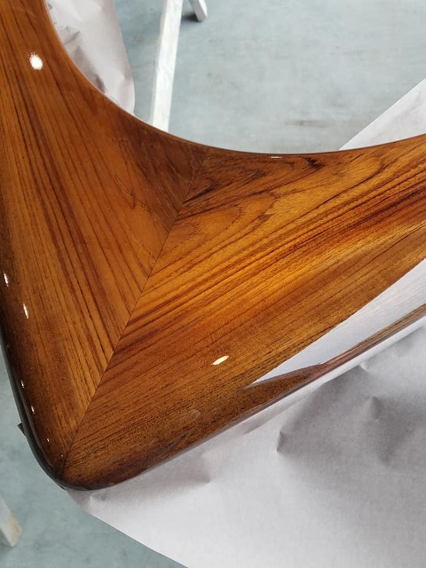

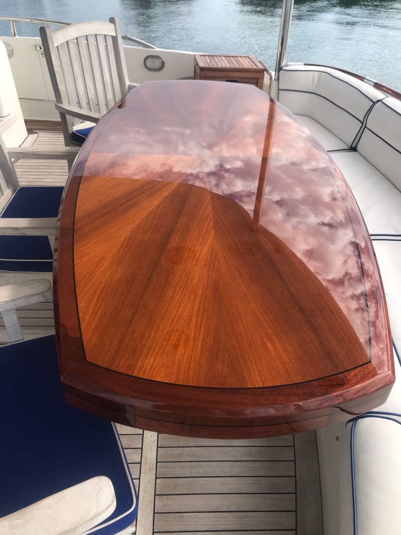

    just had an outside veneered table refinished by BMI yacht refinishing in FTL. Very impressive work. Perfect finish, quick turn around, reasonable pick up and delivery (in Miami). They even delivered it on a Saturday...
    Also kept me posted with pictures along the way. They also do interior work

    Any picture, Pascal?
  16. Pascal
    8,166
  17. Laurent91
    Laurent91 New Member
    May 6, 2018
    24
    Baltimore
    Looks great
  18. Capt Ralph
    12,748
    WHOOW
    That looks great.
    What was the final finish coatings?
  19. Pascal
    8,166
    Epoxy base then Awlcraft 2000
