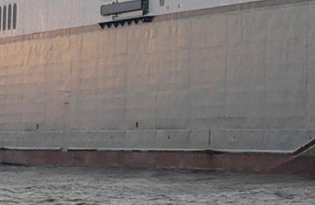

    True statement. With steel, any yard can produce large and sturdy hulls for remarkable low price in very short time. Old saying of shipbuilders: "Empty steel does not cost much". Computer aided manufacturing with CAD data directly transfered to the plasma cutting machine, semi automatic welding and computer controlled robots used for painting, will produce large hulls in no time. Simultaneous production of segments reduces building time even more.
    But if the owner only has cheep building of his new ship on his priority list, he will end up with a vessel like this (This RoRo vessel is only a few years old). I would feel ashamed, to own a vessel like this with my funnel markings on it.
    If you look for a yachtbuilder only under the premise of who is the cheepest, this low quality skin of your yacht will just be hidden under LOTS of filler and paint.:eek:
