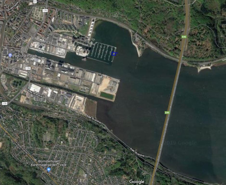

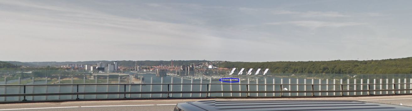

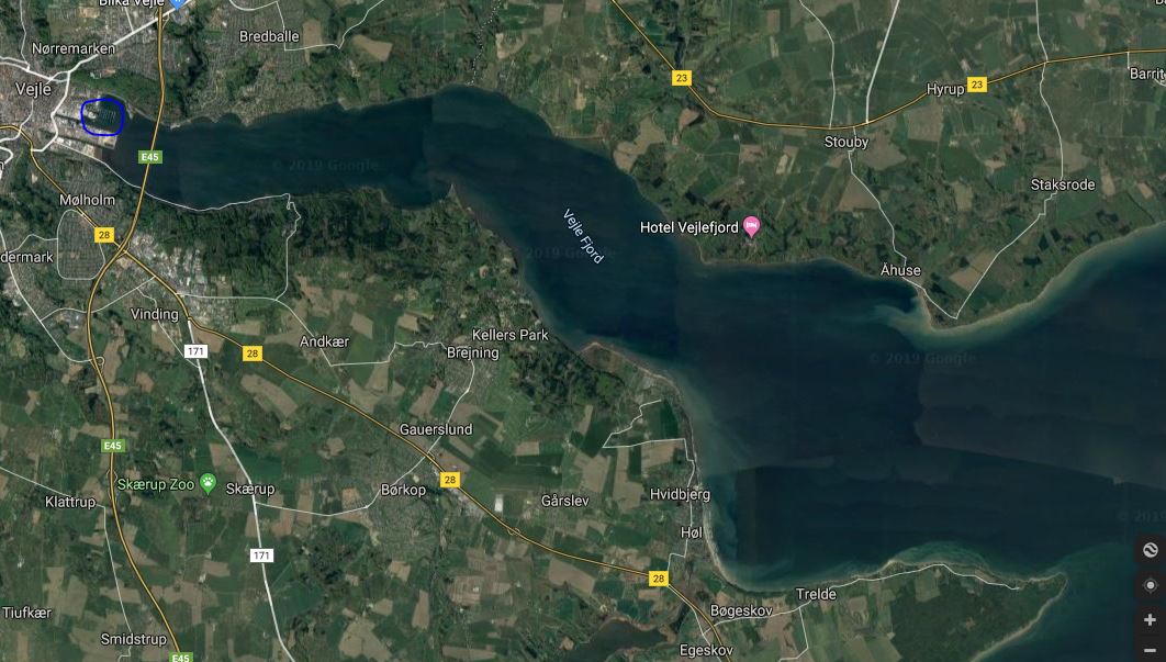

    You are absolutely right - I live in Denmark, and the boat is also going to be moored in Denmark, most of the time in the city where I live, called Vejle. It is at the bottom of a 20 km long fjord with 40-50 m 'hills' on each side and the city opposite the fjord, so it will be quite protected - I have attached a couple of maps - my mooring is at the blue circle. Map of fjord at Vejle.JPG

    You are also right about the hurricanes - we don't have many of them here in Denmark, but the max recorded wind speed in Denmark is 193 km/t (around 120 mph). I the city where I live and the boat will be moored, I don't think the wind has ever been more than 100 km/t (60-70 mph).

    All 7 docks in the photos I posted are floating and also the south dock close to the apportmemts are floating, so they will follow the boat with the tide (which is not that much in these waters, but of cause can be when it is storm and the sea is pressed into the fjord)
    The harbour has been completely ‘rebuilt’ over the last 10 years, with new floating docks with T’s, new solid docks, large wooden walkways, 8 pcs of 10 storage appartmemt buildings, some lower, new floating kayak club housing, new row club housing, restaurent with roof terrasse ..... is has become a very nice place to be
