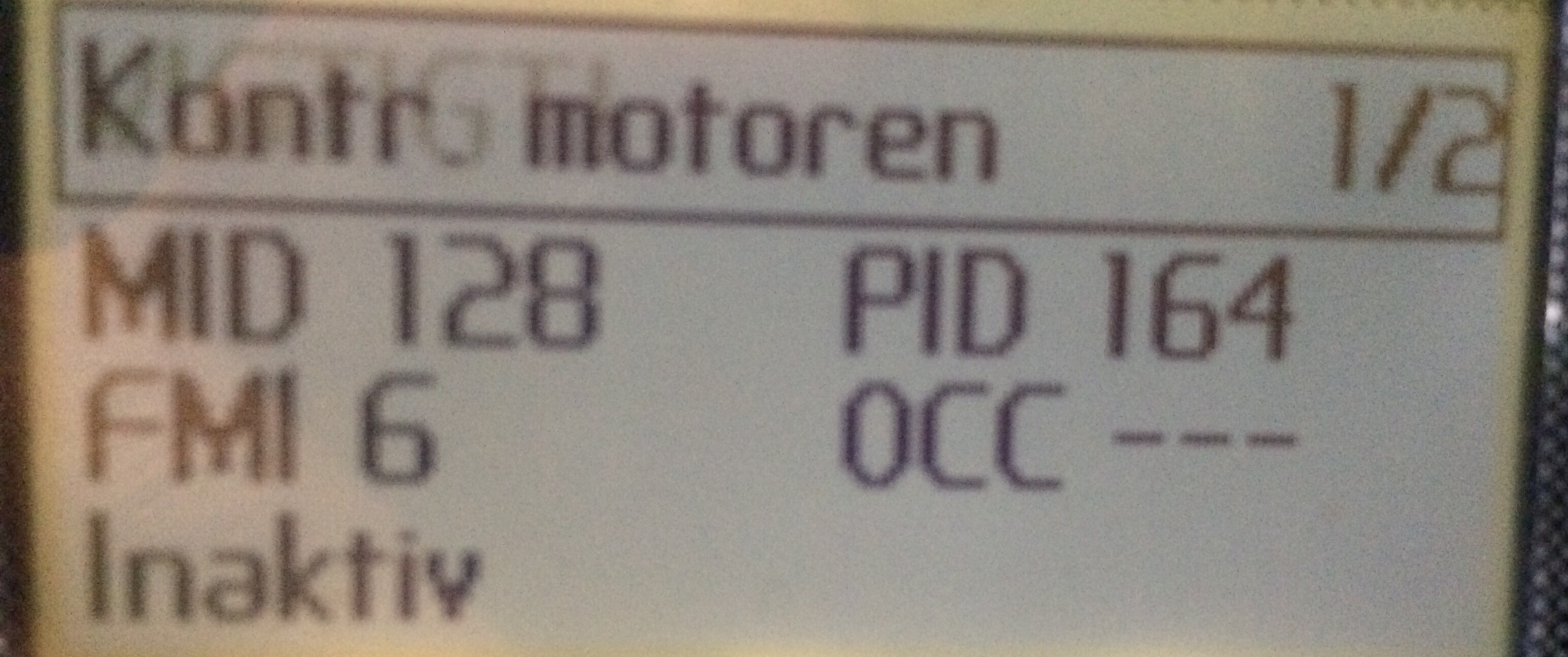

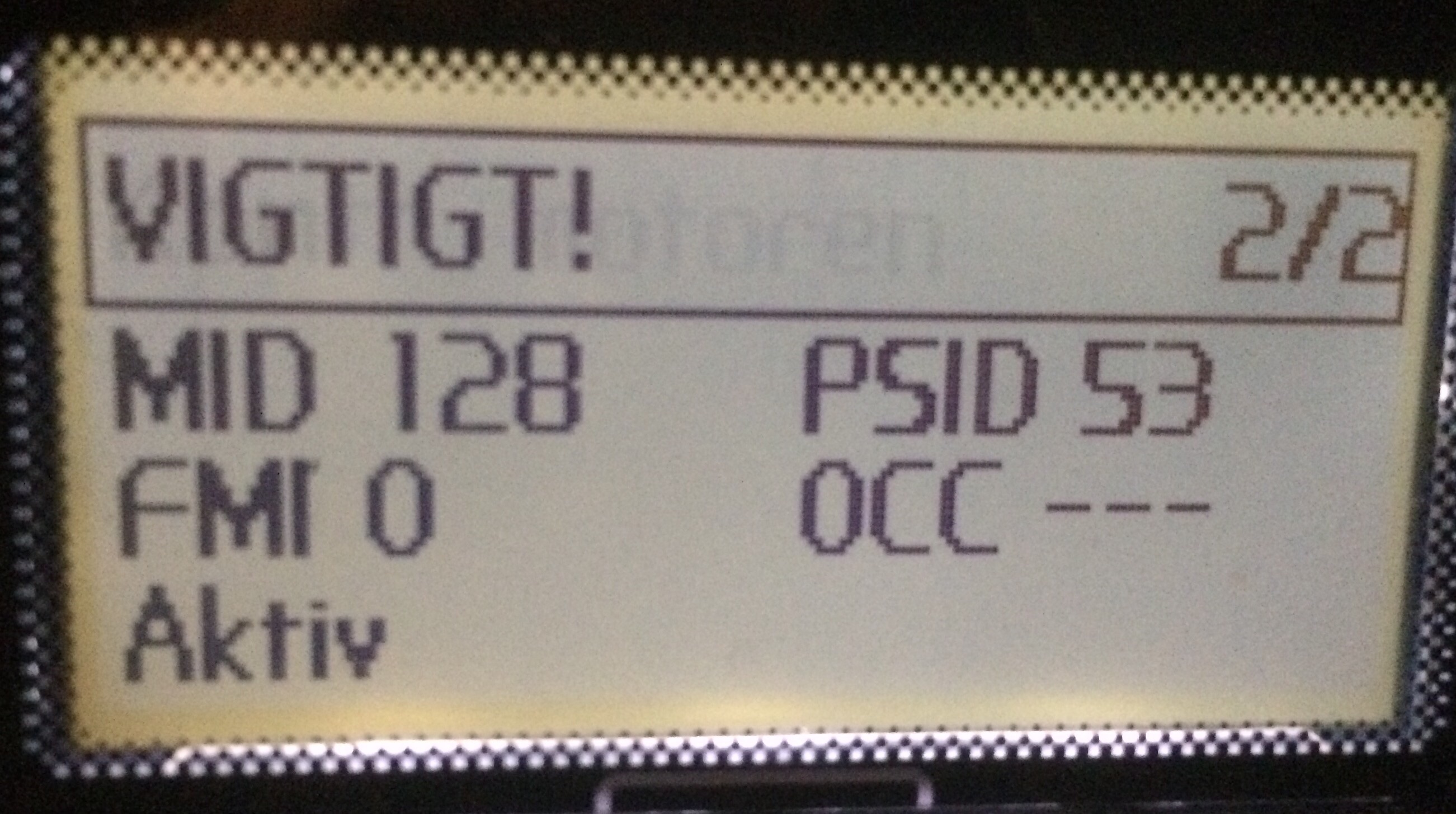

    image.jpg image.jpg Hi
    I got a fault code on my Volvo Penta D4 300 Hp 2012 model 200 running hours: MID 128 PSID 53 FMI 0
    The engine only gets 1600 Rpm.
    The engine is also a bit harder to get started.
    Can it be fuel pressure sensor or MPROP ?
    Have anyone had the same issue?
    I also got an Inactive fault code. How do I delete that?
    See attached pictures from EVC panel.
    Regards Stein Norway

    The Volvo Rep was not to shure, but "Thought" it mighg be the pressure sensor. I have already ordered one. I was just curious if anyone else have had the excact same problem.

    Have you checked your fuel filters??? Fuel filters are usually the first cause of performance issues with a diesel.

    Fuel filters have been changed. So they are new. Waiting for the fuel pressure sensor, that will arrive in a couple of days. If the sensor is faulty, it might give the wrong signal to the High pressure pump and the MPROP(pop off valve) will maintain open. I Will get it changed and let you guys know how it went

    Changed pressure sensor 3843100, and ALL GOOD!!!
    Just in case anyone else has the same problem/alarm,........

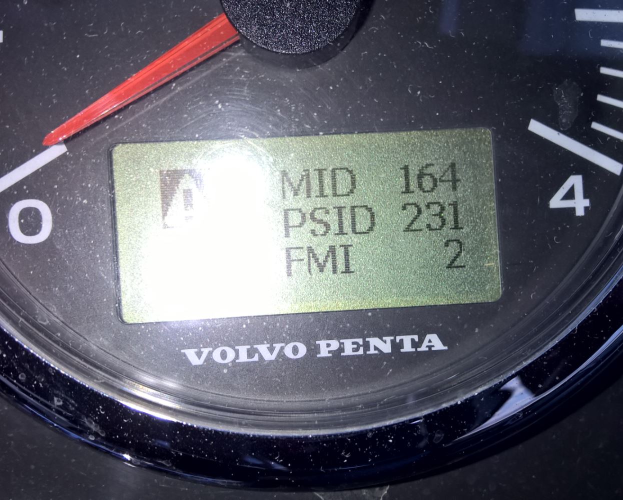

    Maybe someone can help me with my issue which is similar.
    I have one of the Volvo Penta D4 300HP (2009 model with 280 hrs) giving me an error. Error is as follows - MID 164 SPID 231 FMI 2 - Photo attached
    The engines are showing now signs of any problems. Start and run smoothly for about 40mins and then this error is shown on the engine panel and a caution light. The engine keep running smoothly with no visible symptoms. No over heating and no low voltage.
    Would appreciate your assistance.
    Thank you

    Hi, I have a similar issue to JJ Demajo. MID 164 SPID 231 FMI 2. But the symptom is that the actuator shift gear is not working. Can anyone help please?

    Hi did any one solve this fault code? I have the same , I had 8 months of a fault code that my me mechanic said was a bad negative , but was intermittent. Them we came in last week and when we put the boat into neutral the engine stayed in forward gear !! So we replaced the actuator. Now we have the fault case that you all have MID 164 PSID 231 FMI 2 boat runs ok ?? Can any one help ?
    follow up my trim guage on start up goes crazy! From 0-200 but after running for a bit and then turning off ad restarting we have no faults ?
