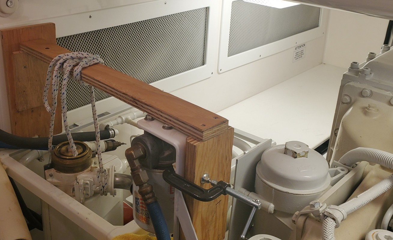

    I replaced the motor on my EI 600 last winter. Most parts are Scotsman ice machine parts. Sounds like you need a new gear reducrion box. Parts are becoming scarce. I was fortunate to be able to hunt down a new in box motor. All the professionals told me they were obsolete.
