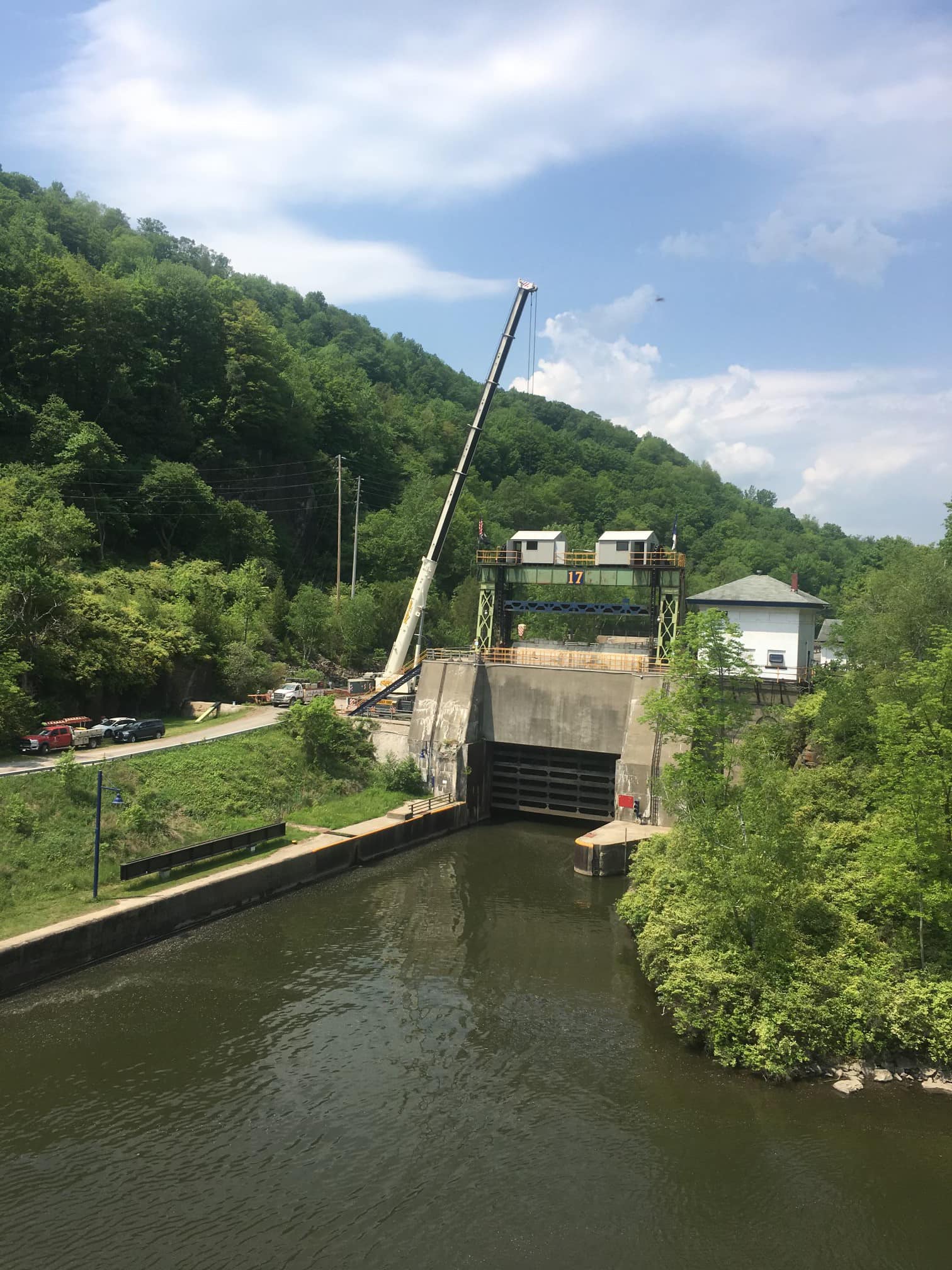

    They brought a crane in from Pennsylvania last night and set up today. They did some test lifts of the gate today.
    They hope to start moving boats tomorrow it will take a while as there are lots of boats. All marinas and tie up walls are full. L17.jpeg

    The New York State Canal Corporation today announced that Lock E-17 (Little Falls) will resume operating under temporary conditions at 11:00 am today, May 28th.
    Lock E-8 (Scotia) through Lock E-16 (St. Johnsville) will resume allowing vessels through the Mohawk Valley on a staggered schedule beginning at 12:00 pm today, May 28th. Mariners should contact their closest lock for details on the local reopening time.
    Locks E-2 (Waterford) through Lock E-22 (New London) will remain open throughout the Memorial Day weekend for normal hours of navigation and all through vessel traffic will be able to transit toward their destination.
    All vessels should arrive at Lock E-17 (Little Falls) by 4:30 pm to be locked through on the same day.
    Overhead clearance at Lock E-17 (Little Falls) is reduced by approximately 1 foot. Any vessels over 22' height should confirm actual conditions when approaching the lock.

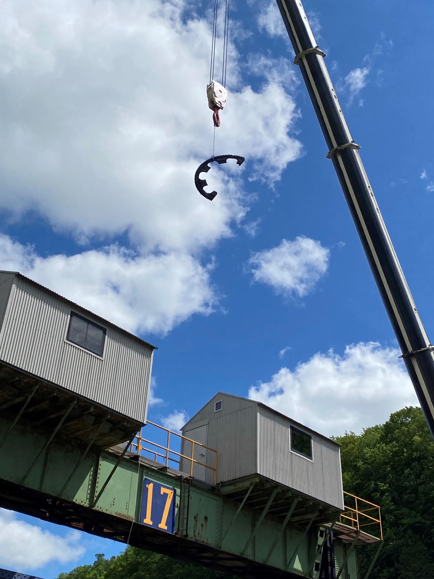

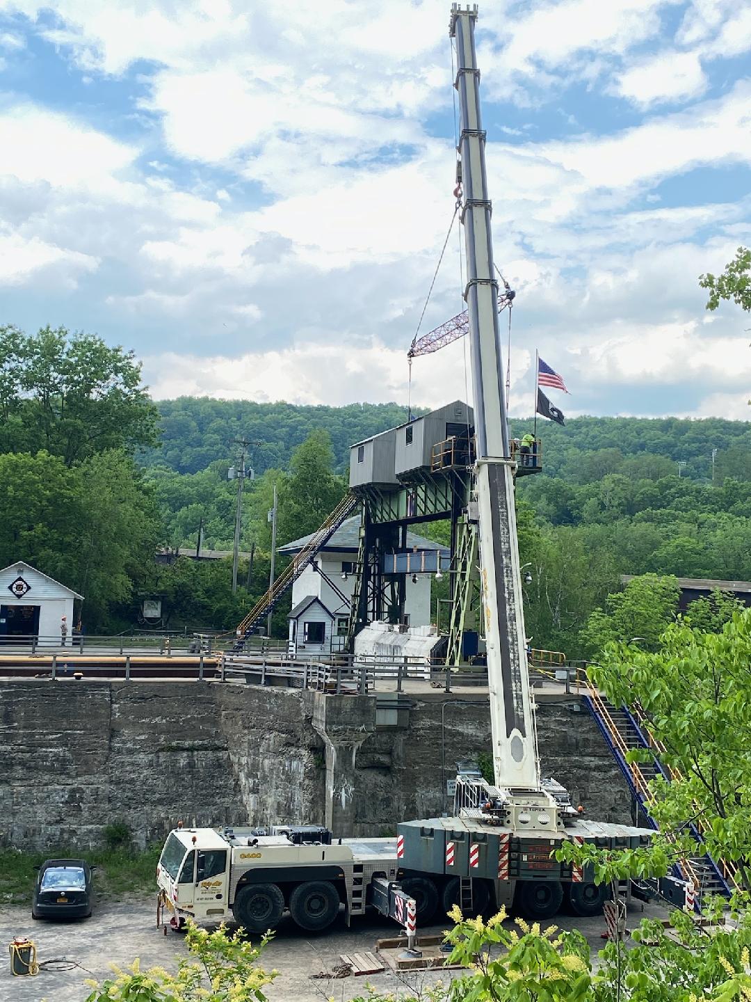

    Mariners should anticipate minor delays at Lock E-17 (Little Falls) due to the temporary use of a crane while the permanent repair to the lower lock gate’s lifting mechanism is designed and custom fabricated. Also, the crane’s operation is subject to temporary stoppages due to winds, lightning, and/or other adverse weather conditions.
    All mariners are remined to maintain safe speeds, control their wakes, and to obey all posted Canal speed limits.
    The Canal Corporation anticipates closing Lock E-17 (Little Falls) for another short duration in the middle of next week to allow for adjustments in the crane’s operation. Updates will be provided in a timely manner so that mariners can adjust their itineraries accordingly.

    Taking up a 112' Westport on Sunday then yachts will start arriving Monday from Erie Canal will have a busy week. lk1.jpg lk2.jpg lk3.jpg lk5.jpg

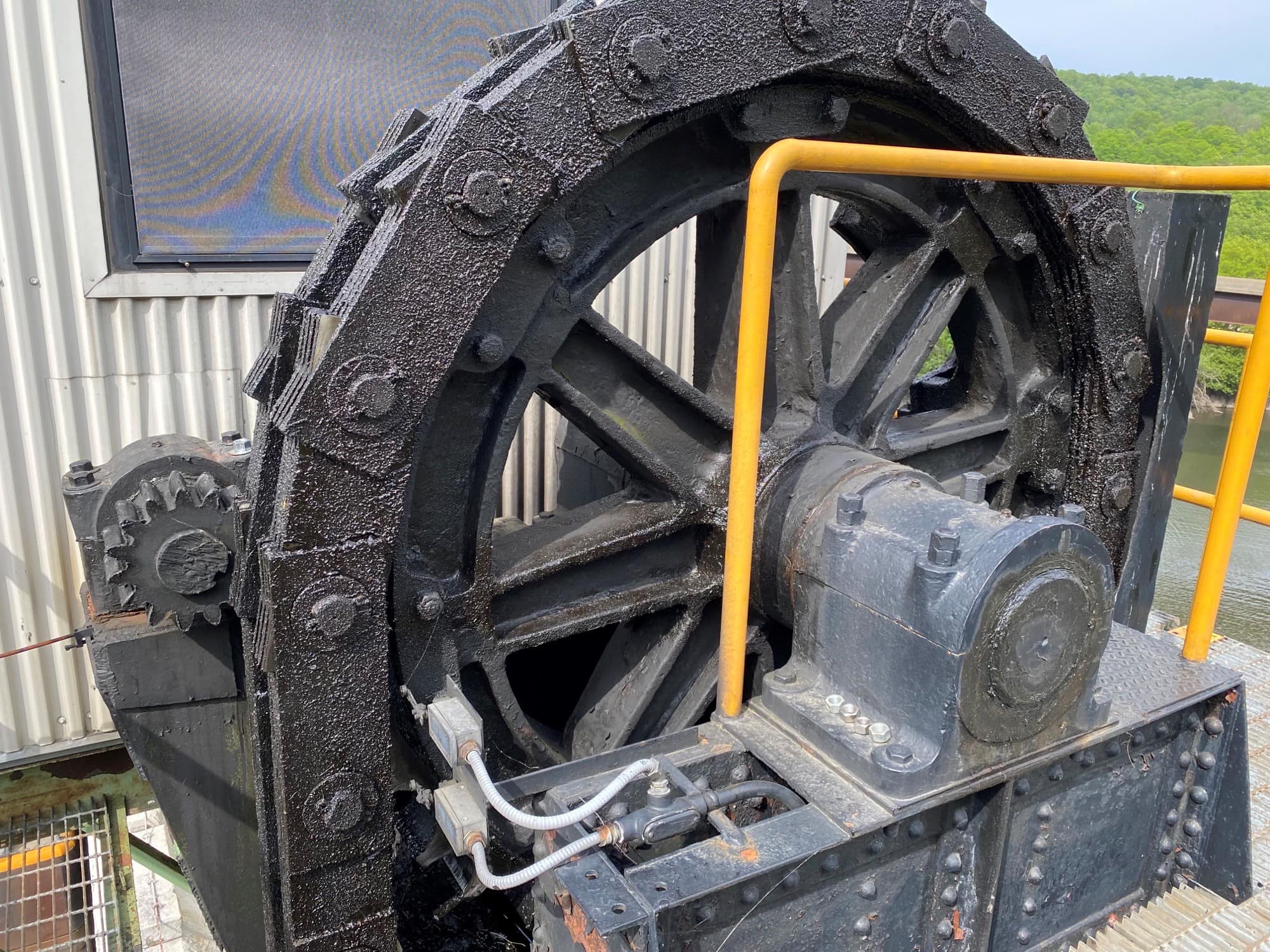

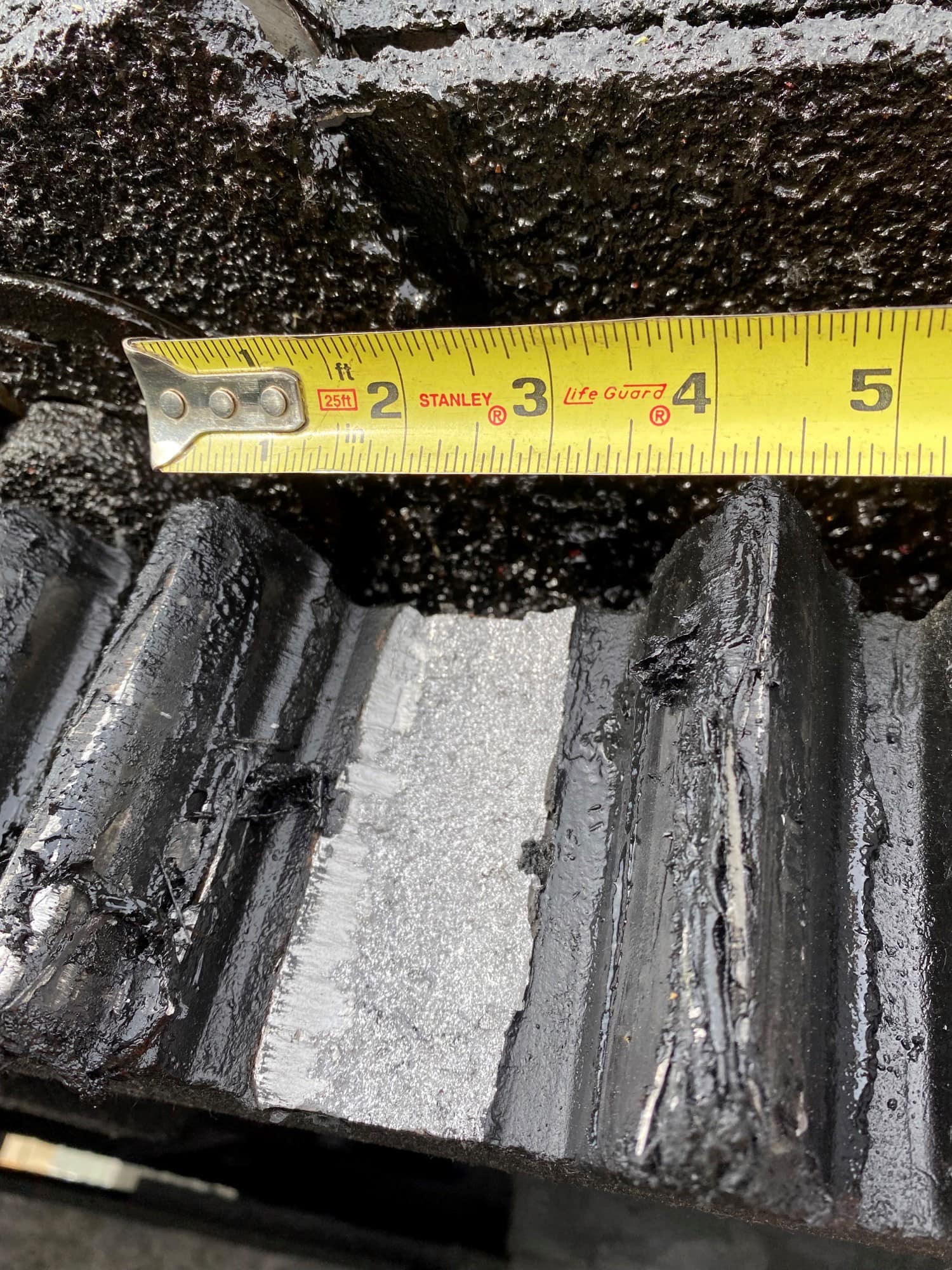

    On Saturday, May 22 the lifting mechanism that hoists the lower gate at Lock E-17 (Little Falls) broke after 64 years of continuous operation. At 40.5 feet, Lock E-17 has the highest lift on the Canal system as the Erie Canal steps up through the Mohawk Valley and the seven-foot diameter gear was custom designed and fabricated by the Philadelphia Steel Company in 1957. It is one of two identical gears that operates the lower lock gate and due to the lift required, these gears are unique to this specific lock.
    The gears are made in two halves that are bolted onto the side of the sprocket gear that holds the chain for lifting the gate. The broken gear was disassembled and we are now developing a plan to custom fabricate the repair. While this work is underway, the lower lock gate will be temporarily operated by a crane.
