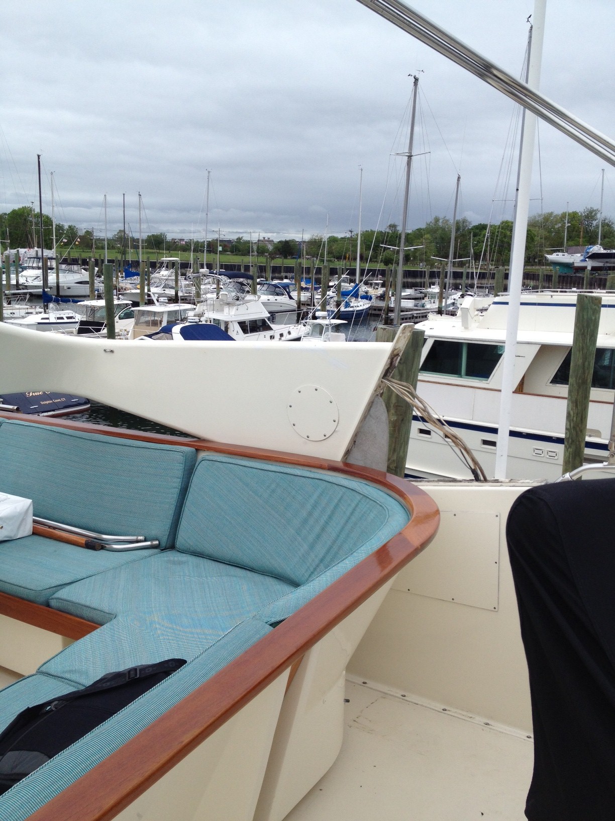

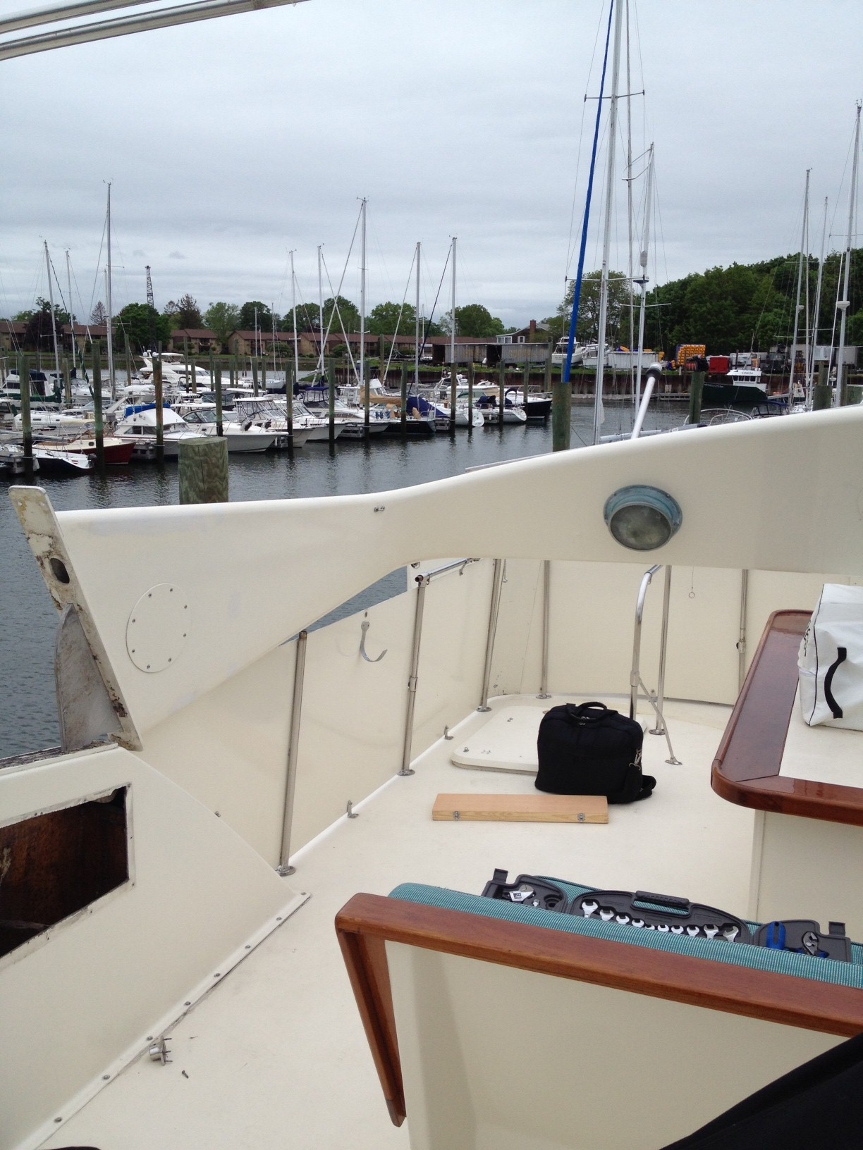

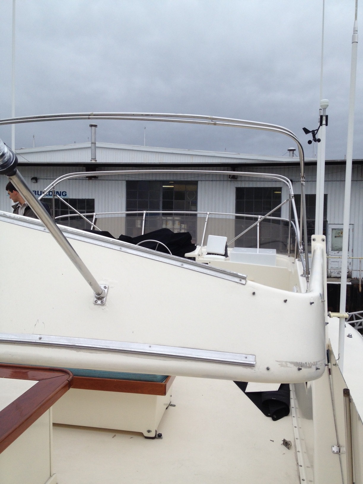

  18. NYCAP123
    11,205
  19. David Helsom
    David Helsom Member
    Sep 23, 2019
    114
    Sturgeon Bay/Fort Lauderdale
    Wow makes things look easy and gives me confidence in self removal. I might be at the boat tonight so I will take photos. The 1989 60’ has an enclosed flybridge area that is smaller then a lot of old Hats. It does however have a large fantail area that should hold the arch. Again pictures as soon as I can.

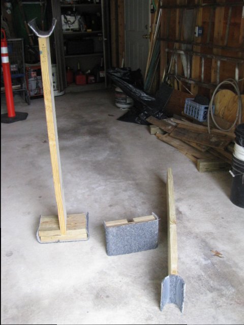

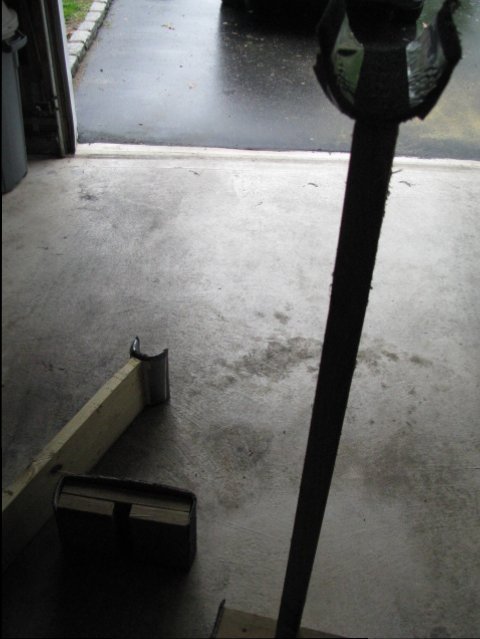

  20. NYCAP123
    11,205
    Arch stands
