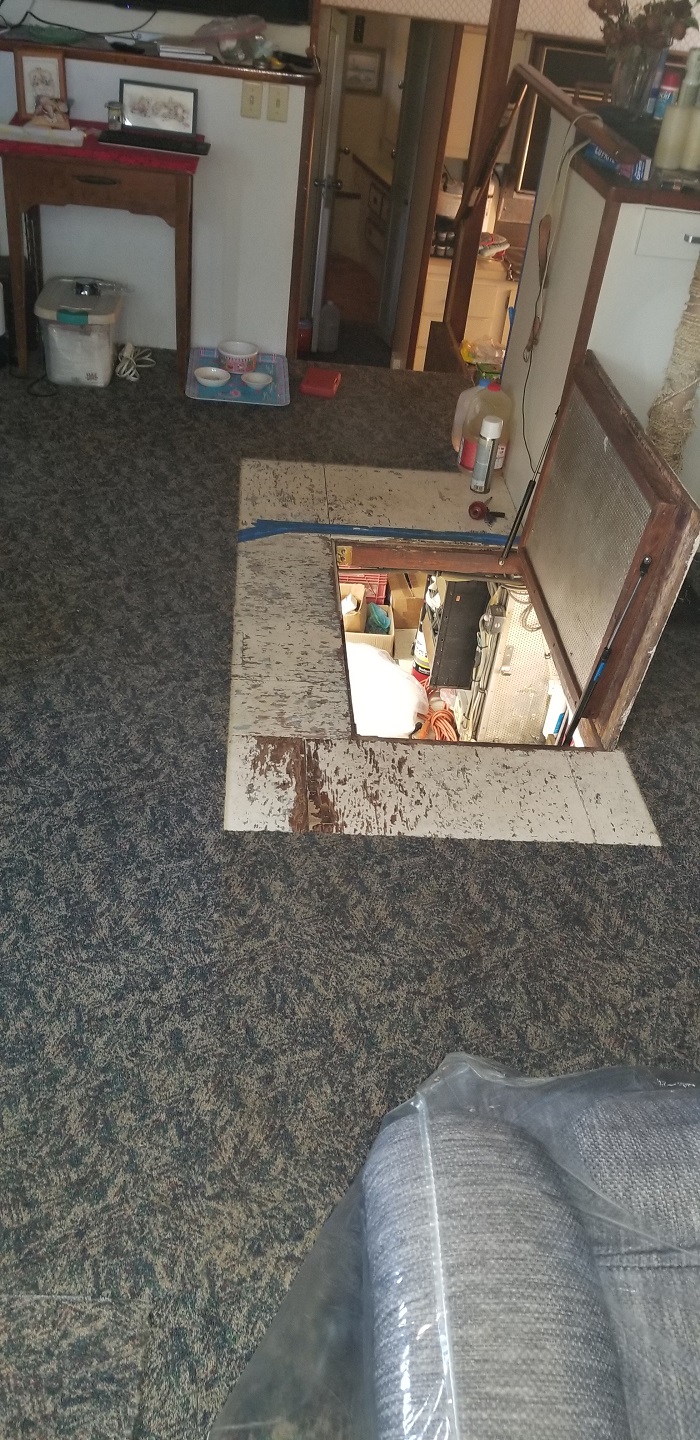

    I took a quick picture to show our E R access and the carpet.
    3 x 3 office floor carpet squares that we have lots of spares for. When one gets stained beyond cleaning, a new square replaces it.
    Also left room around the E R hatch to reduce wear on the squares.
    When we cruise, the 2 lifted squares are squeezed back in place and you can not see any seems.
