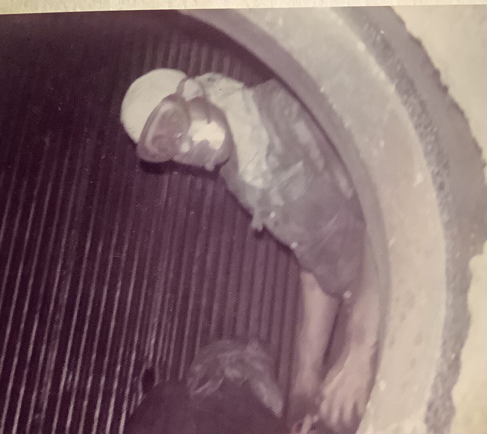

    On the big ships we had air conditioned control rooms within the engine room, but
    not on my first ship in 1974: 12,000 HP 2-stroke diesel in the tropics and we were all sweating but stayed skinny because we worked in a sauna.
    Yours truly cleaning a boiler, dirty work and the Chief gave us a case of beer and half a day off after the job was done, no air condition. :(
