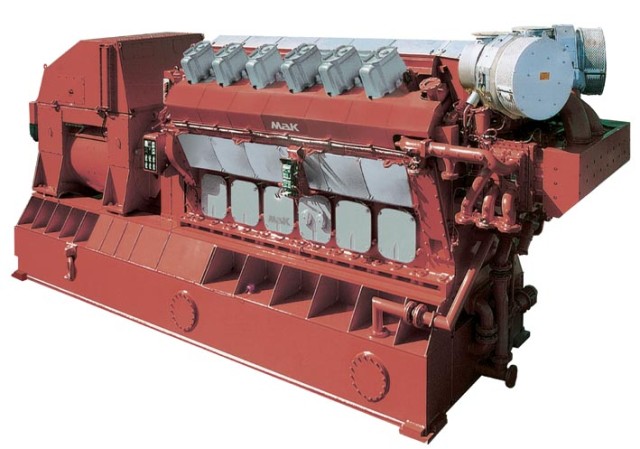

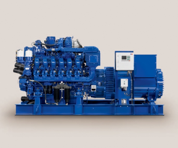

    This is what I would call a big Genset
    This is the normal size and type of Genset we normally deal with, if not working with HFO fuel

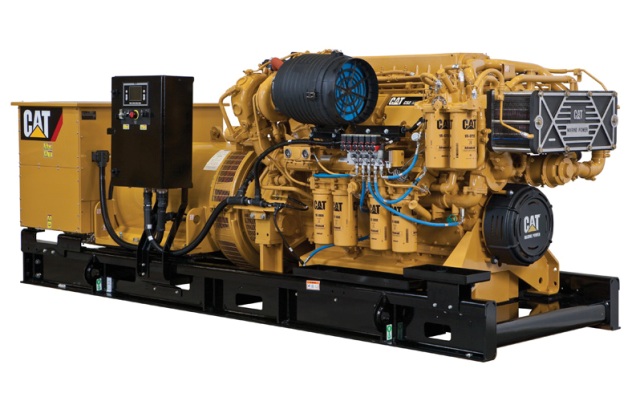

    I believe this is the size of Genset you think KIWI is dealing with

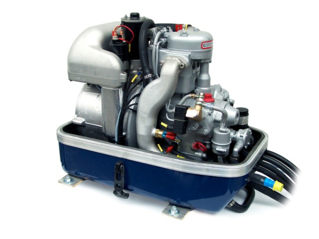

    And this is what I would call a small Genset. Sorry Eurotrash, I know :).
    And this little banger can not be mistreated. He runs on almost anything that burns. But without a soundshield, he will mistread you, especially your ears. The good old Faryman single cylinder diesel. But almost all small marine generator producers are still using this engine. And for the hardcore user, their is an air cooled version without soundshield. That is more painfull than Jimmy Hendrix and Meat Loaf together.

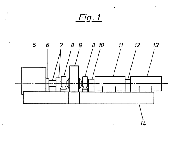

  9. HTMO9
    HTMO9 Senior Member
    Jan 13, 2009
    1,681
    That is exactly what I did try to explain in my humble english Marmot. You are 100 % correct.
    fig.5 would be the diesel engine
    fig.7 clutch and hydraulic coupling
    fig.9 the flywheel
    fig.11 the alternator
    fig 13 the electric motor
    Plus some other electrical gimmicks to keep the components from fighting each other :).
    The flywheel is spinning all the time and is only used to start the diesel engine and drive the alternator til the engine is running. when the Net is working again, the electric motor cuts in again and the diesel is disconnected and stopped. We have two of those in our office building. Pretty heavy stuff. The Net does not recognize any power cut at all. But this is old but reliable technology. The future belongs to battery/ static inverter buffers.

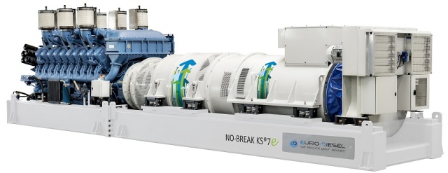

  13. HTMO9
    HTMO9 Senior Member
    Jan 13, 2009
    1,681
    There it is, the No Break Emergency Generator. Pretty heavy stuff. Our ones are definately a little bit smaller.
    That must a little earthquake when the flywheel starts this MTU 20 V 4000 diesel engine.
