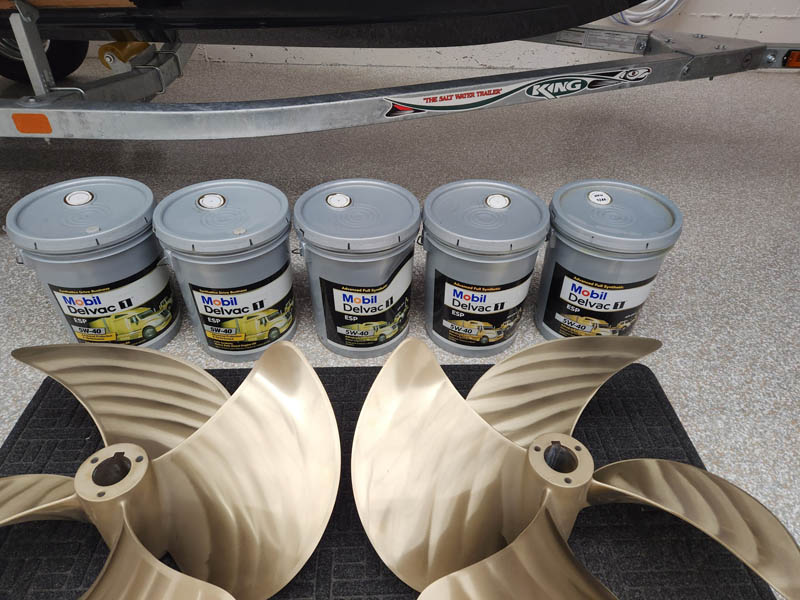

  11. CaboFly
    CaboFly Active Member
    Aug 24, 2018
    276
    Seattle
    Common Rail Diesel in Seattle
    Mobil Delvac 5W40
  12. Capt Ralph
    13,858
    Gold in the garage. I hope big dawgs are there guarding these..
  13. CaboFly
    Aug 24, 2018
    276
    Seattle
    Coastal Farm Supply had a few stores that decided to stop carrying Mobil 1 Delvac. My avg price per pail was under $75. I cleared both locations out. Told them if District Mgr decided to do any addtl stores call me direct. Happy to help.
  14. Capt Ralph
    13,858
    I found the Mobil distributor in N/E FL years ago and have been doing business with them directly since for our MAN customers.
    If you have any kind of company credentials (Fed ID and tax number) or a friend with, I'd call your local Mobil distributor directly.
    My partner has luck shopping the internet. Hit & miss but shopping and stocking has save him big bux. Sometimes free shipping with a min order.
    Freaking cheaper than jobber cost sometimes.
