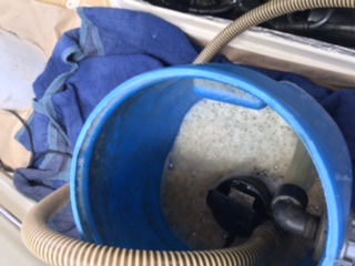

  7. Norseman
    Norseman Senior Member
    Feb 24, 2005
    2,931
    Now circulating the acid for 2 hours:

  12. Norseman
    Feb 24, 2005
    2,931
    1) Engine has been running cool since I bought the boat 2.5 years ago.
    2) Boat and engine is 19 years old, descaling has never been done before as per detailed maintenance records.
    3) The above made me nervous and with 5 heat exchangers it was time and way too much work pulling each cooler/heat exchanger off and cart to a radiator shop for an acid bath.
    4) Pleasant maintenance procedure: I sit in the shade with a cold beer while the descaling process is going on, running backwards to flush out any impeller piece or debris from the intake.
    5) Preventive maintenance only, no problems noted before.

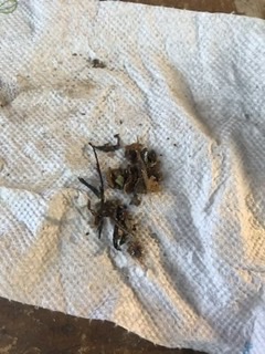

  19. Norseman
    Feb 24, 2005
    2,931
    No screen on the Yanmars:
    I have pulled the end-caps a few times and found some gunk:
    Also found the raw-water strainer had a small hole in it, (in addition to many other smaller holes) new strainer installed a few weeks ago.
    James from Overtemp said impeller pieces was unusual with Yanmars.
    At any rate, should be good to go now.
