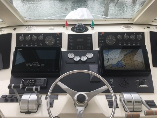

    Last year (I think) I had a professional install 2 Furuno TZT2s (15” screens), new VHF new depth finder, 2 engine room cameras, new radar, new stereo and I believe it was 37K labor and material, installed. I had him do the dash a second time and did some other wiring work while there.
