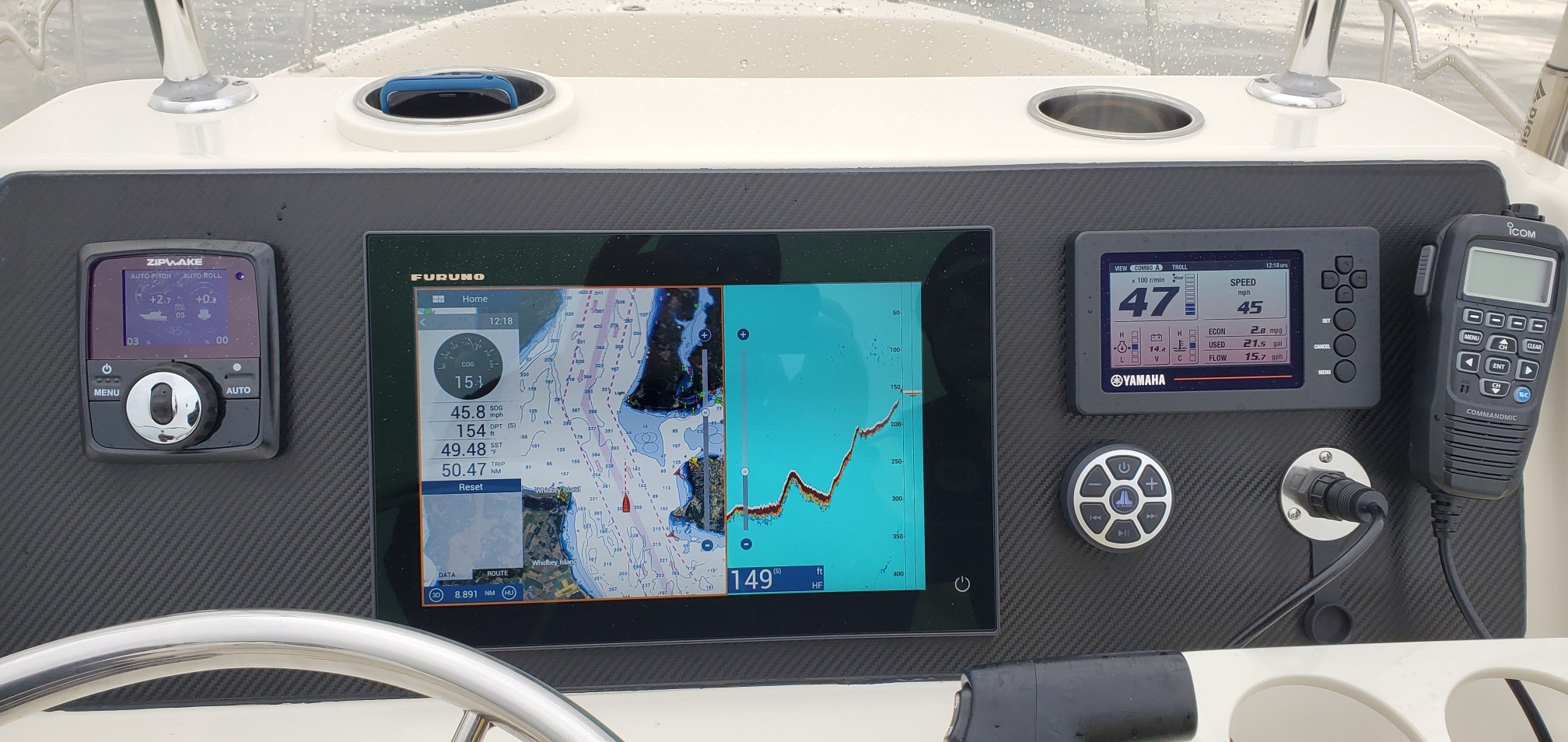

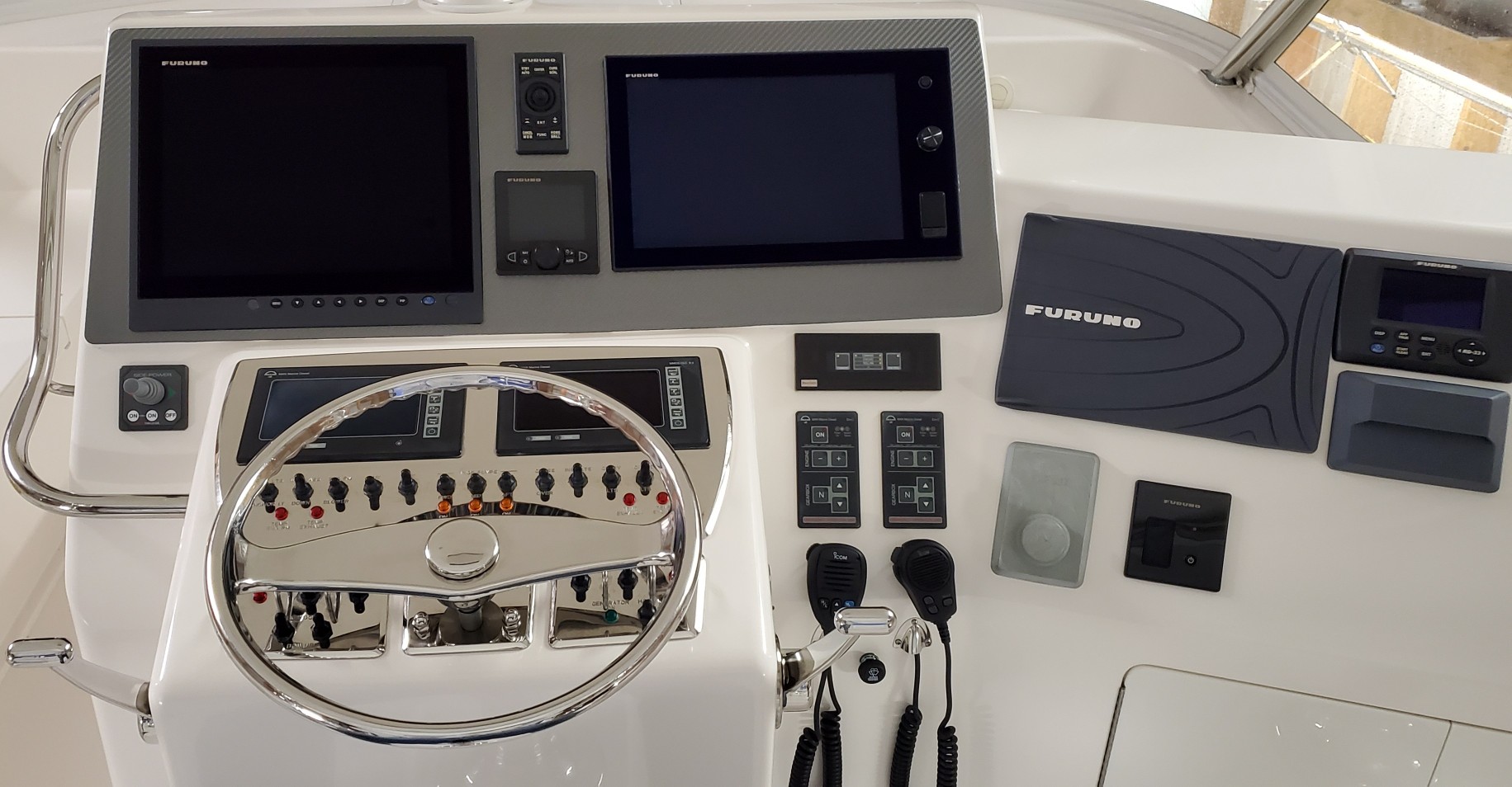

    Aluminum with studs tapped into the backside for securing to existing dash. Wrap with 3M Dinoc carbon fiber. Have done both my Cabo and Pursuit cc and very happy with results.

    Very excellent work! I am constrained, unless I change the entire helm, to match the existing (engraved) dash material.

    Great idea, CaboFly! I've wrapped my car's outside rear view mirror with that exact 3M material.
    Beau, It's easy to change the appearance of many things with THIS stuff. It comes in all kinds of colors and patterns. Instead of matching a panel, wrap the existing panel to match the new panel, is what CaboFly is suggesting, I think.
    The car wrapping videos on YouTube are entertaining.

    Except that means removing and remounting all my gauges - that enlarges the project? ...and I like the look of the existing black matte finish. But it's a great look, indeed.

    Well, you're in there anyway :)
    The wrap comes in matte black, so you can pretty much use any flat surface material.
    There could be a fade factor on the older panel, so "matching" may not be matching.
    C'mon, go with camo! :D

    That 3M material looks great! Checking out the youtube videos now to see how much of a pain it could be to apply in a professional attractive manner

    Almost anyone could do it on a flat, clean surface. The stuff is forgiving, too. I screwed up doing compound curves on my mirrors more than once. Just peeled it off and tried again. Several times. I wrapped one with the cheapest No-Brand stuff eBay had to offer, and it was a bit harder to work with. The other I wrapped with the same gray carbon-fiber 3M that CaboFly has, and it's thicker and easier to work with. I wish they had this when I was doing installations. One boat I can think of had all that plastic wood-grain in several panels. I had to order replacement panels to match. With this, I could have made them all match
