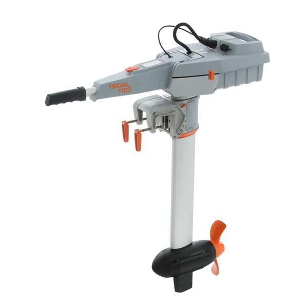

    We have probably more than 2 dozen Torqeedo 1103 C electrical outboard engines plus a spare battery for each outboard on our boats. But not for professional use, only as propulsion for the toys for the kids, my grand children and their friends.
    They are used for small tenders, mostly Honwave 285 fully inflatable dinghies or for little sailing dinghies and Hobby Cats.
    They work flawless, require no installation on the dinghy, the battery is on the outboard and can be exchanged in seconds, they are waterproof, if submerged, can be lifted by a kid (only 25 lbs) and spare parts are cheep (except the battery :)). A new prop for example costs about 35 $. And with its power, they are below the requirement for a drivers license and can therefore be used by the kids regardless of age.
    Again, a nice toy and as a dinghy propulsion for smaller boats, pretty much perfect but not for professional tender propulsion and for every day prolonged use. For this purpose, I would prefer internal combustion engines for range, performance and independence. Here we are using only diesel outboards, as we do not want gasoline fuel at all on our boats. But they are only used by licensed drivers.

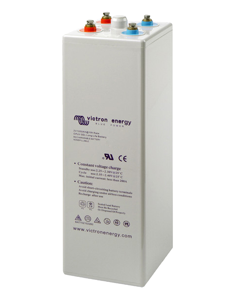

    I have one boat, a 39 ft wooden replica of a historical launch with a 30 KW, 48 volt DC, electric inboard propulsion with shaft and conventional prop for use on the Binnenalster (the intown water ways in Hamburg), where combustion engines are forbidden for private boats. But this boat is purely for coffee cruising during nice weather with guests and family on a sunny afternoon. The battery pack allows cruising at app. 5 kts for 5 to 6 hours with 12 people on board. The batteries are Victron 2 volt VRLA (Valve Regulated Lead Acid) batteries (forglift batteries) mounted horizontally under the floor boards and switched to an high capacity 48 Volt battery array. They have a life span of up to 20 years and are very reliable. Pretty heavy set of batteries but very usefull in this case, for the stability of the boat.
